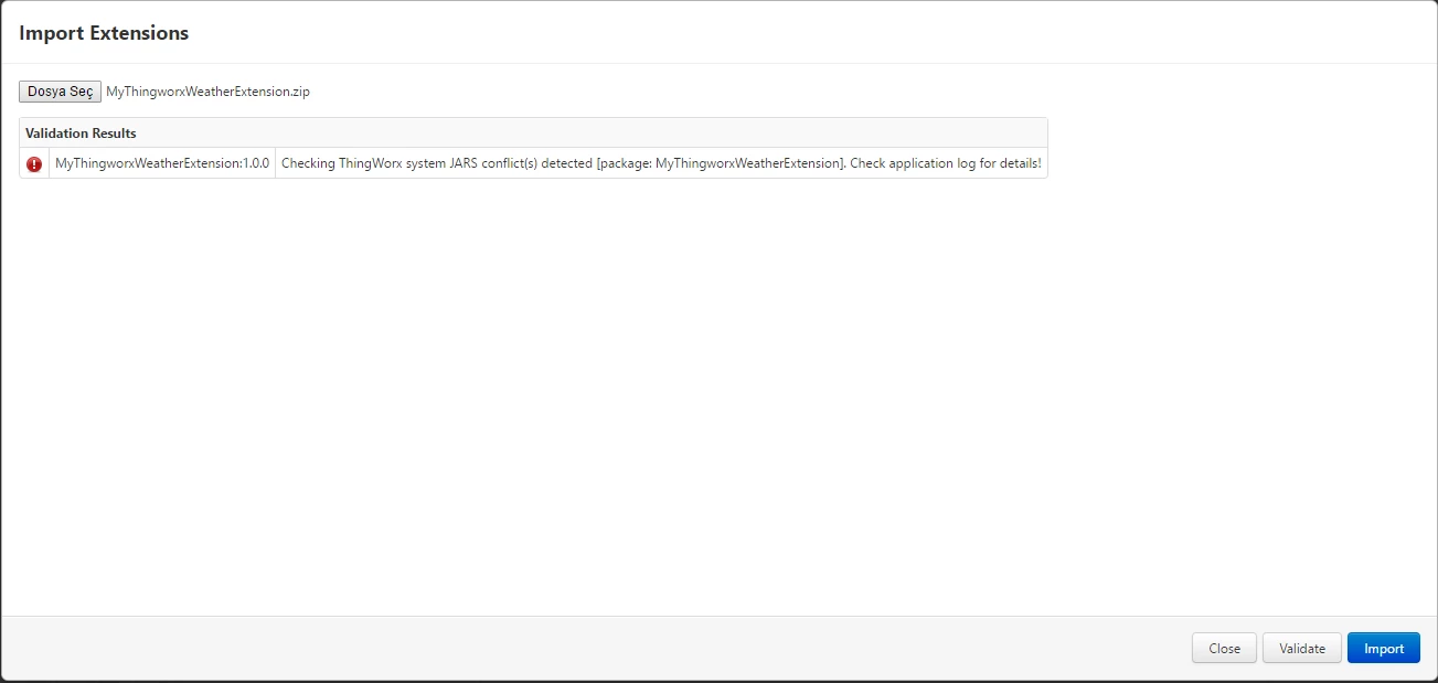

I had an error, shown in the attached screenshots  "Checking ThingWorx system JARS conflict(s) detected" while importing one project.
Do you have any idea? Thank you in advance.

Hi Burak Tunc​,
Are you trying to update an existing extension or import a new extension?
Try restarting your ThingWorx instance to see if it helps.
Ankit Gupta
ankigupta5-Regular MemberAnswer

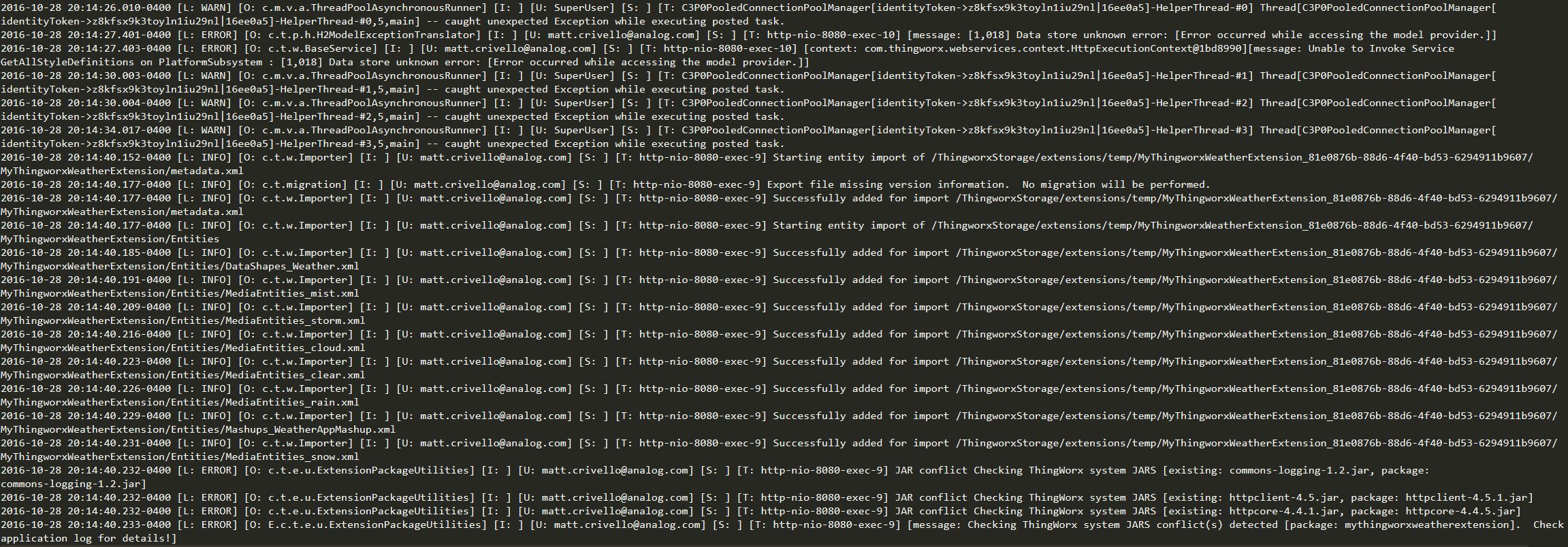

Burak Tunc​ Please attach screenshot of the Application log as well.
Restarting would might  not help here as its jar conflict issue.
October 28, 2016

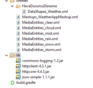

I have the same problem Burak Tunc had. I'm going through the thingworx extension tutorial and it seems like he was as well. The conflict arises from the 4 jar libraries that the tutorial instructs to import. It mentions that the build path in the project should be configured to point to the twx-lib folder for these libraries but the folder is hidden from eclipse. I think it is the thingworx extension hiding this folder but I'm not sure. Is there a way to fix this error? I have attached the application log error for my instance.

     "Possible pitfalls: 1. JAR Conflict arises between two similar jars.
      Solution: JAR conflicts arise when a similar jar is already present in the Composer database. Try to remove the respective jar resources from the       metadata.xml. Add these jars explicitly in twx-lib folder in the project folder inside the workspace directory. Now, build the project and import the extension       in ThingWorx Composer once again."
As well as fixing the name of the jar resource in the metadata.xml from "mythingworxweatherextension.jar" to "MyThingworxWeatherExtension.jar". It seems as though the Thingworx plugin removed all the capital letters from my project name when modifying metadata.xml file.
