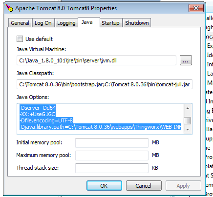

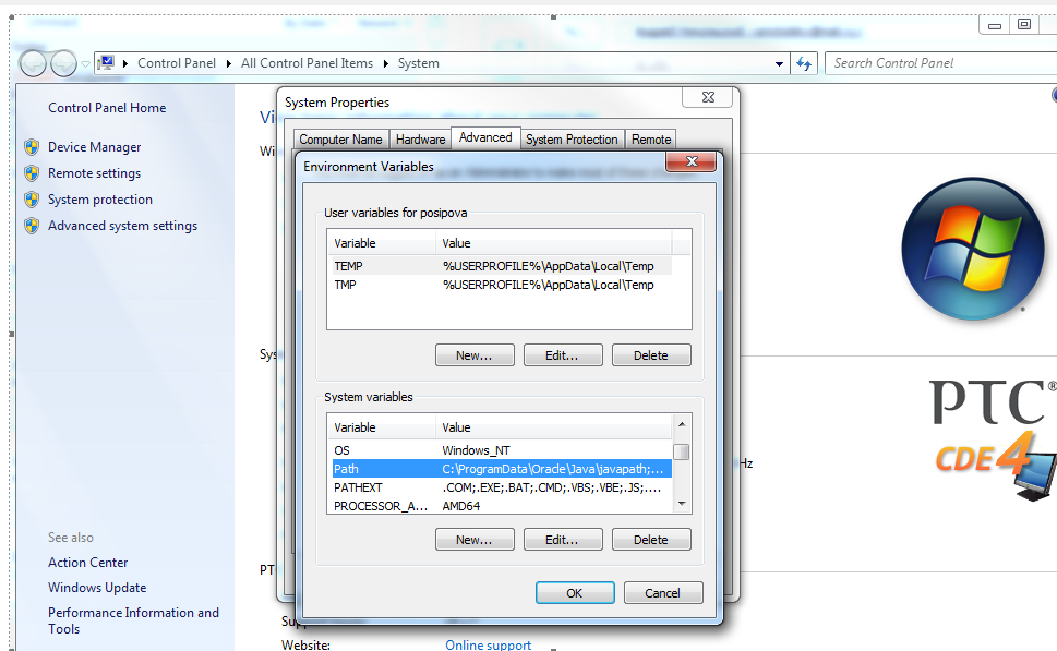

Best answer by posipova
Are you on Windows?
If so, try the following:
1. Remove the path from your tomcat Java  tab, just keep these settings:
-Dserver -Dd64
-XX:+UseNUMA
-XX:+UseConcMarkSweepGC
-Dfile.encoding=UTF-8
2. Go to explorer, right click on "my computer" -> Properties -> Advanced settings -> Environment variables -> edit "PATH", add ; and then path to your tomcat extensions folder, “ ;<path to extensions folder of tomcat> “ or, for example ";C:\ptc\Thingworx\webapps\Thingworx\WEB-INF\extensions"

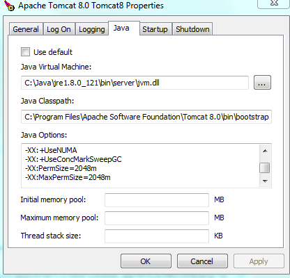

Dimitri Bologna​ Eric Fernandez​
Could you please try below steps and share feedback:
1.Stop tomcat
2.Delete Thingworx folder and Thingworx.war file present inside Tomcat webapps. ( Backup if you have something important)
3.Configure Java Options in Tomcat as below:
-Dserver -Dd64
-XX:+UseNUMA
-XX:PermSize=2048m
-XX:MaxPermSize=2048m
-Djava.library.path=C:\Program Files\Apache Software Foundation\Tomcat 8.0\webapps\Thingworx\WEB-INF\extensions
Please refer KCS article for more details : https://support.ptc.com/appserver/cs/view/solution.jsp?n=CS195506&lang=en_US
4. Copy the Thingworx.war file and place it in the following location of your Tomcat installation:
5. Obtain the license.bin file from the download package and place the license.bin file in your ThingworxPlatform folder.
NOTE: The location of the ThingworxPlatform folder varies, as it is determined per your initial set up. Failure to place the license.bin in the ThingworxPlatform folder will result in ThingWorx not starting after deployment.
6. Launch Tomcat and verify Thingworx login.
If you still have issues please share your tomcat, java and OS versions along with Tomcat logs & ThingWorx Application logs.
-Durgesh

Hi Durgesh Patel​,
I have attached the logs in a previous message. Tomcat 8.0, Java JDK 1.8.0_121, Windows 10, PostgressSQL 9.4.11. Following your steps I was able to run Tomcat and it not shutting down, however it was like in a constant loading loop and nor the localhost nor Thingworx loaded.
Thank you very much,
Eric
April 12, 2017
This worked for me too, thank you Polina! This should be added to the installation document! Thank you very much all.

I had the same issue, adding the above Tomcat Configuration (slightly different configuration from previous release), adding extension folder to path along with ensuring copying the license file to Thingworx Storage fixed.

April 30, 2017
Before the workaround, I added the following lines in the Tomcat Java options:
-Dserver -Dd64
-XX:+UseG1GC
My "ThingworxPlatorm" folder containing the license the bin is at:
C:\ThingworxPlatform
I was following v1.1 of the "Installing ThingWorx 7.4" document.
After I removed the path in Java options and placed it in System Path, it worked.
