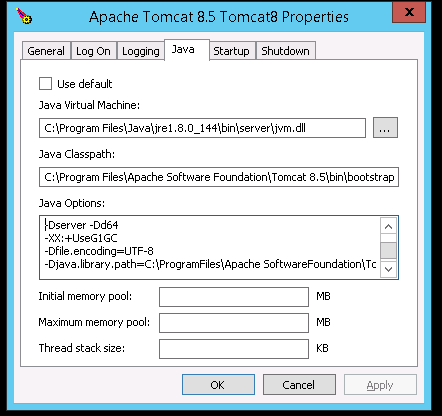

Try removing the Djava.library.path from Java Options field of Tomcat , restart Tomcat and let me know the result.

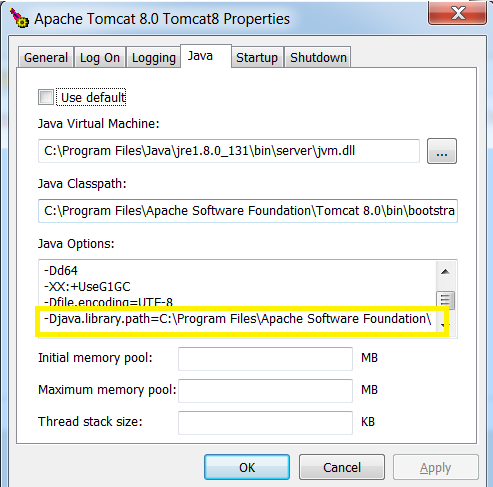

That is a common license error.. Almost there ! Did you add -Djava.library.path=<path to Tomcat>\webapps\Thingworx\WEB-INF\extensions to the Tomcat Configuration's Java Options ?
October 5, 2017
If you had already done that and still face the error, try the resolution in this link 7.4 ThingWorx does not launch due to license error in Windows

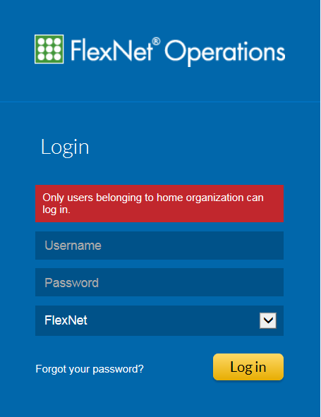

I think the problem lies in the in FlexNet login/licensing.... If i try and login to my FlexNet Operations even after resetting my password I get  hit with a Only users belonging to home organization can log in.
who would be the best to contact about this?
Thanks again
October 5, 2017
Yes! PTC is currently experiencing an issue with FlexNet Operation Server. It should be corrected soon. But looks like you are error free from your side
October 5, 2017
Will keep this thread posted once we get an update regarding the FlexNet server issue..

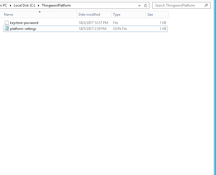

Can you tell me what are the files present in your ThingworxPlatform folder?
joel_m4-ParticipantAuthor
October 6, 2017
Hey Janet,
I'll include a picture of my ThingworxPlatform folder. There should only be two items in it correct? The keystore-password and platform-settings. I recall in Thingworx 8.0 you need a license.bin file but with 8.1 that isn't necessary, validation occurs via the platform-settings file correct?
Thanks again for your help.
October 6, 2017

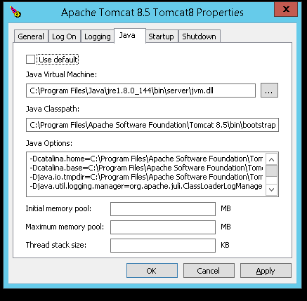

That's correct. Just curious, did you add the path to Tomcat->WEB-INF->extensions to the environment variable path? . If not refer this   and share the logs after doing so.
October 6, 2017
Hey Janet,
Yes, this path was applied to the end of the Path Environment Variable -> ;C:\Program Files\Apache Software Foundation\Tomcat 8.5\webapps\Thingworx\WEB-INF\extensions

Joel,
October 6, 2017
Janet,
Success! I am able to start Tomcat and log-in to ThingWorx and can view the composer! Thank you so so much for your help. The last loose end to tie up is a licenseRequestFile was added to the ThingworxPlatform. From my understanding, this was because validation could not occur via the platform-settings.json file and I have 30 days to validate. What steps do I need to do for validation? Previously when I logged in to FlexNet I saw 4 different activationIds, once the FlexNet server is working again, do I just grab one of those keys and place it in the platform-settings file?
