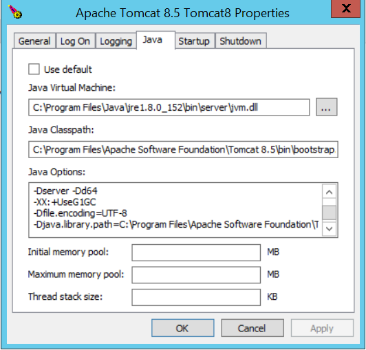

I'm trying to install Thingworx 8.1 for the first time on an azure virtual server. Installed programs:
jdk-8u152-windows-x64
apache-tomcat-8.5.23
postgresql-9.5.3-1-windows-x64
platform settings.json file:

Thingworx.war is deployed on Tomcat but white start page shows up. Application log is below. Is it a license issue?

Best answer by jdass
I ran your platform-settings.json in a JSON Validator and found a missing comma. You database will not be able to make a connection to the Thingworx Application if the platform-settings.json is invalid.
Use this format and let us know.

November 17, 2017
Also , Postgres 9.5 is not supported at this time. Please downgrade to PostgreSQL 9.4
System Requirements Thingworx 8.1 - http://support.ptc.com/WCMS/files/173583/en/ThingWorx_Core_8.1_System_Requirements_1.0.pdf
