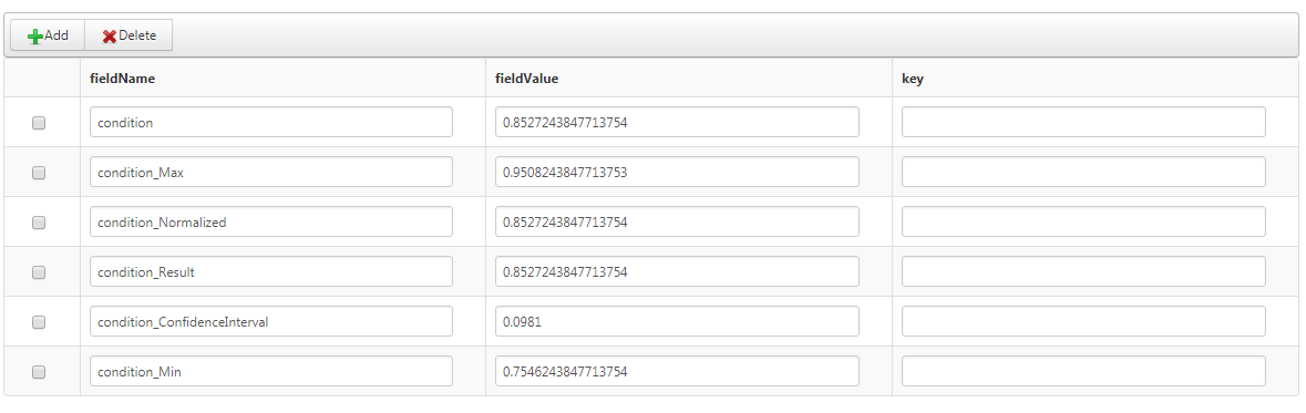

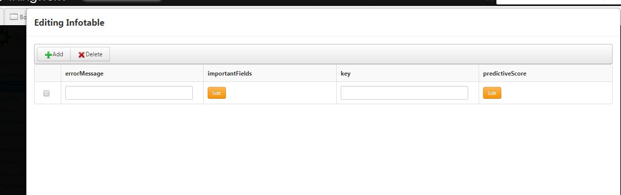

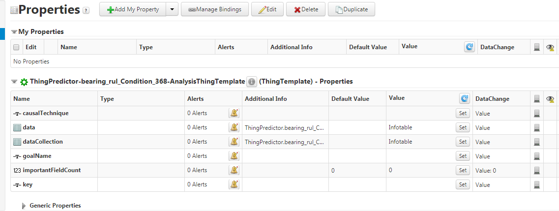

I am attaching three screen shot which gives the graphical sequence of execution to determine predicted score value. Here property "condition" is my target value. And "datacollection" property is where my result of scoring will be persisted.
I have written below service code but no luck, I am not seeing any output.
var score = me.dataCollection.getRow(0).predictiveModelCollection.getRow(0).predictiveScore;
var tableLength = score.rows.length;
for(var x =0; x<tableLength; x++) {
    var row = score.rows;
    if(row.fieldName == "condition") {
        me.condition_predicted = row.fieldValue;
        x = tableLength;
result = me.condition_predicted;
​Please do let me know, if I have done any mistake here.
