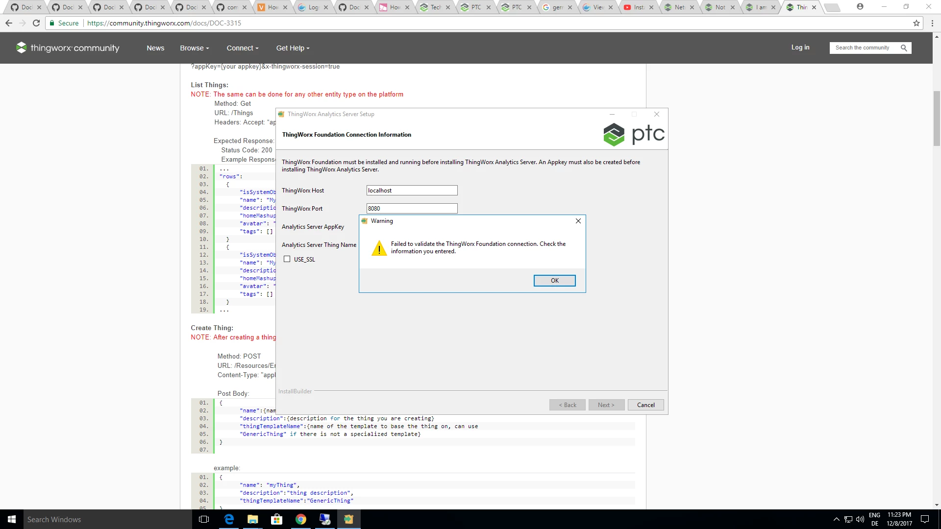

I am trying to install Thingworx Analytics Server 8.1 on a Windows 10 VM using the docker installation process. While installing the analytics server, after entering the ThingWorx host and AppKey, I am getting an error message of failed validation for the Thingworx foundation connection (please see the attached screenshot).
Just to check that if the AppKey is working, I tried some simple PUT and GET request test and the key seems to be working.
However, I would like to point out that my ThingWorx core is installed on a different VM (Windows Server 2012 R2). Is this maybe the reason for the failed validation? If yes, what can be done to rectify this?

Based on your suggestion, I installed the AnalyticsServer on a new linux based VM (stand alone or without the docker version). I am now able to see the AnalyticsServer thing in the TW core as well as, in the Analytics Builder.

Hi Tushar
You wrote that you are attempting to install ThingWorx Analytics on a Windows 10 machine while ThingWorx Core is on a Windows 2012 machine.
Consequently they are not on the same machine, however in the installer screenshot you have entered localhost for the ThingWorx host.
This should point to the Windows 2012 machine, which is different form the Windows 10 on which you are installing, so you should use the ip address of your ThingWorx Core machine, not localhost.

Hi Christophe,
Thanks for the reply.
I have tried to put in the IP address of the TW core machine (Win 2012) as well, but it didn't work too.
Also just to make sure both the machines are running at the same time, I first run my Windows 10 VM and in that VM, I run my Windows 2012 VM, but still, it is not validating and I am getting an error message.

December 11, 2017
Hi Tushar
When you are on your Windows 10 machine on which you want to install ThingWorx Analytics, could you open a  browser and access your ThingWorx Core server ?
If you can, could you use the same information for host in the installation wizard ?
