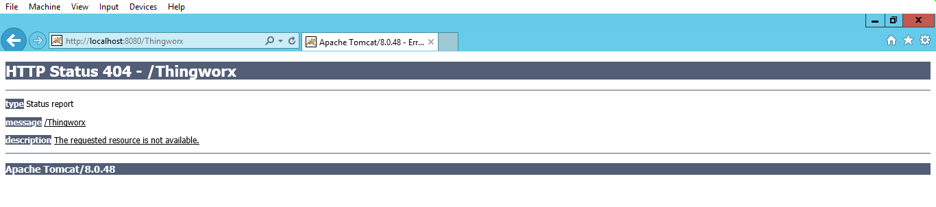

Hi Mahaboob,
I almost done, anyhow unable to launch composer. Getting error like below
Any suggestions for the same ?

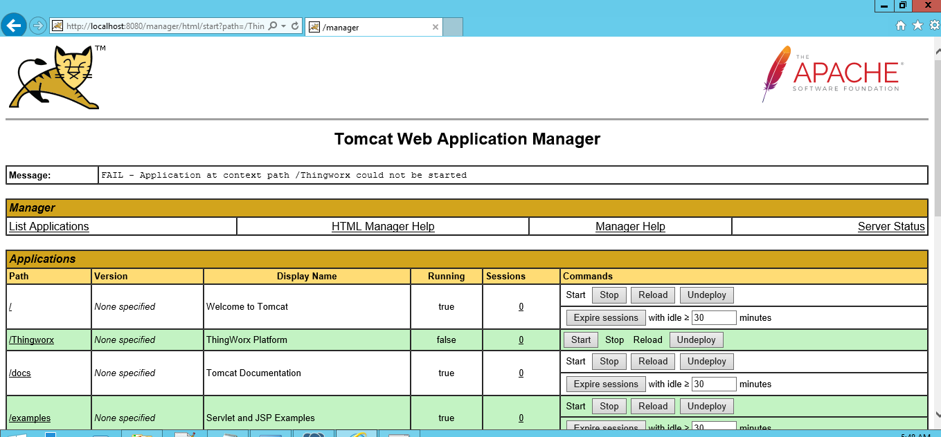

December 22, 2017
Hi All,
Getting below error while trying to launch Thingworx...
Krishna
December 22, 2017
Make sure you are using windows x64 - You can actually deploy without errors on an x32 but it will not start
Check the location of apache it should be C:\Program Files\Apache Software Foundation not in program files
mnarang5-Regular MemberAnswer
December 27, 2017
Hi Krishna ,
As this is resolved now ,the problem was with keystore .It could not load kestore so deleted keystore file and restarted the server with deployment .
