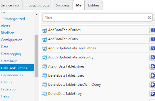

Whether you are storing them in a DataTable or externally in a RDBMS system you will need services to perform those operation. If you are using DataTable you can utilize some of the inbuilt services of a DataTable

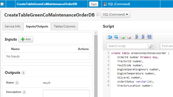

If you are using external DB, for e.g. Oracle or MS SQL, MySQL, you'll need to create your own services with SQL (much like you would do directly on SQL database) and that Service type will required to be of SQL type (SQL Command or SQL Query - depends on what you are intending to do with that Service) for e.g.

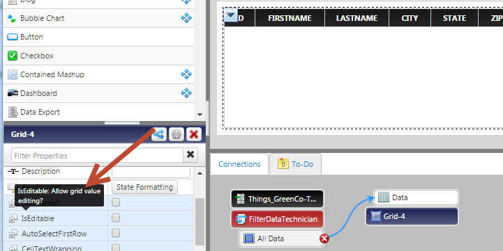

Editing is quite straight forward, you can either use the Grid's own functionality of making rows editable by enable the isEditable something like this and then handle the selected and edited values via your services

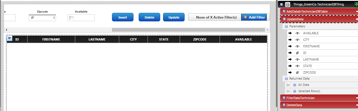

or you can simply use some value boxes and CRUD buttons on the mashup and bind the data and the action via the respective services, something like this
