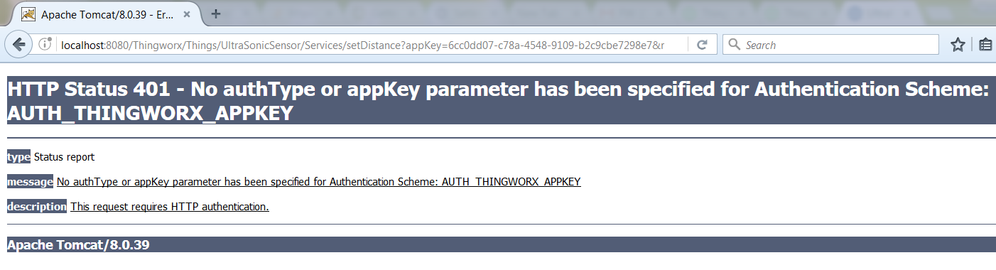

Basically, I'm trying to demo by connecting an ultrasonic sensor to my local H2 based Thingworx Copy.
When running Thingworx on localhost on Chrome, On a new tab, If I try to run this URL below to run service which sets the value of my Ultrasonic Sensor:-
http://localhost:8080/Thingworx/Things/UltraSonicSensor/Services/setDistance?appKey=6cc0dd07-c78a-4548-9109-b2c9cbe7298e…
Then it works and mashup also updates.
However, if I try to run the same link with another browser, it doesnt work. Also, if I try to run this same link  with Python using requests.post("http://localhost:8080/Thingworx/Things/UltraSonicSensor/Services/setDistance?appKey=6cc0dd07-c78a-4548-9109-b2c9cbe7298e…"), It still doesn't work.
Please help.

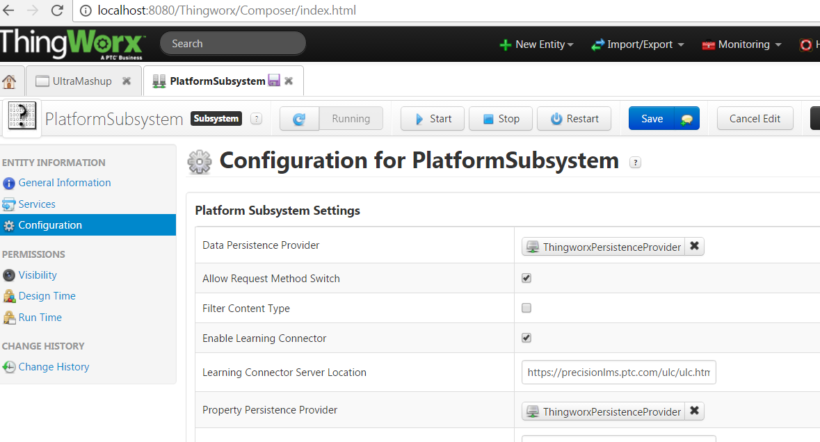

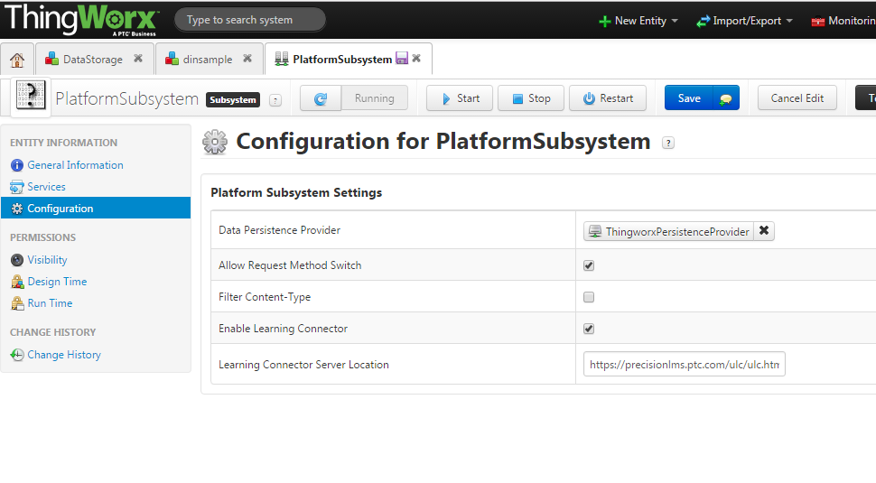

     you should do small change  subsystem,if you are using 6.0 or later. you should do this,
Go to Systems> subsystem>PlatformSybsystem in composer.Within the subsystem, open configuration and check the box next to Allow Request Method Switch and un-check the box next to Filter Content-Type. refer the attachment.

I've already done that configuration in my browser.
I receive no errors when I use Chrome to execute the command. (When thingworx local instance is running on Chrome)
This is the error I get when I try to run it in Firefox:-
This is the error I get in Python as well:-

It seems I was using wrong App Key =P..
Positive point I noted from this thread is that even if you put wrong app key in the same session which is authenticated, It still works even if you're using wrong app key.
