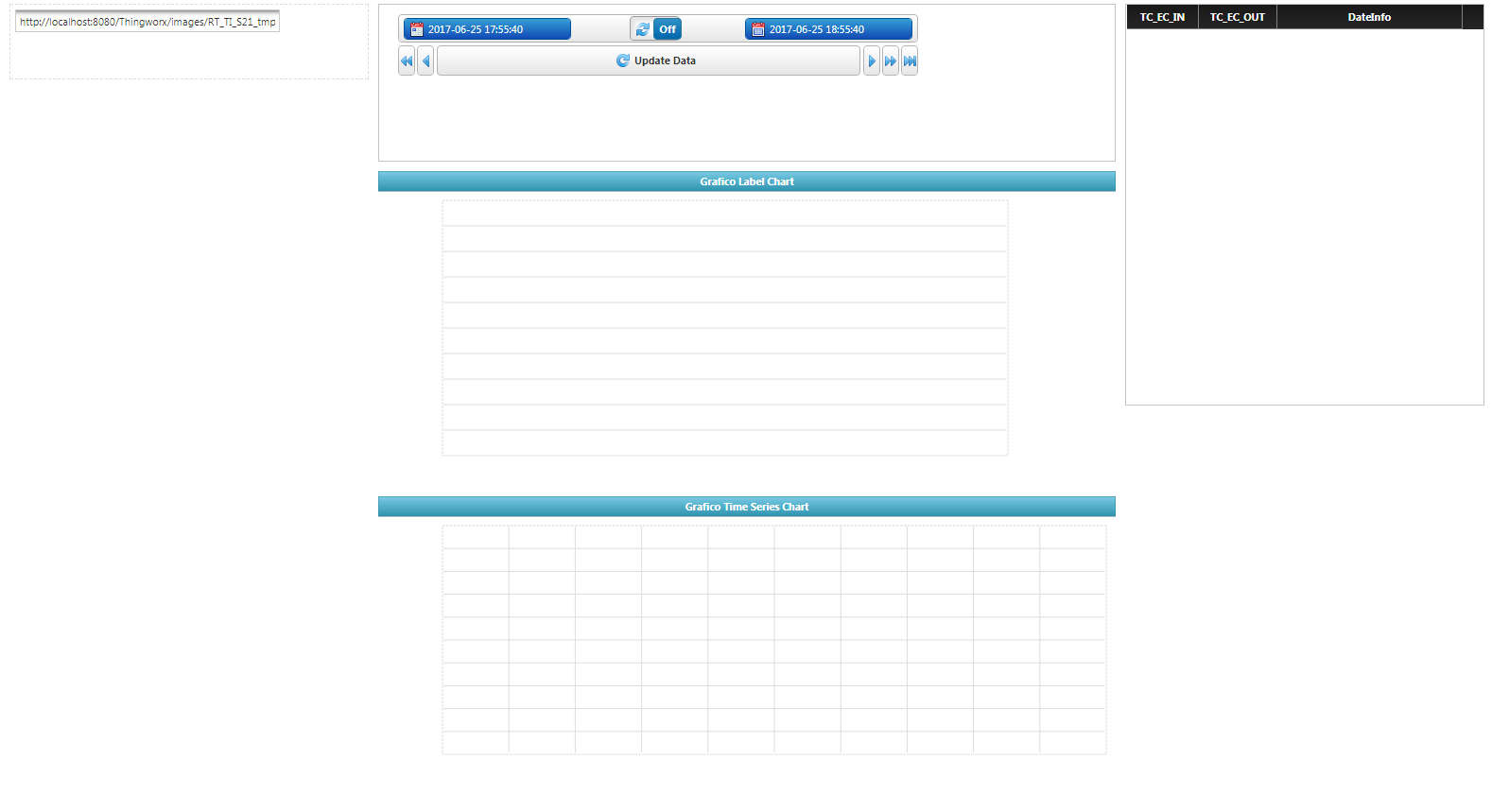

When I'm using Google Chrome
the widgets google map and Three Model Viewer are not see on Mashup.
The following are the mashup on Chrome

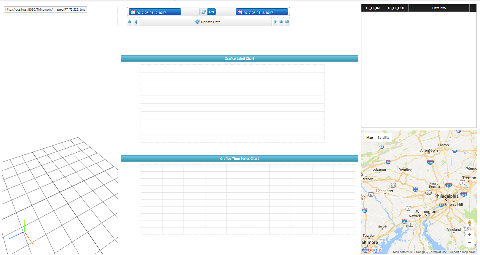

next picture is the same mashup in Internet Explorer 11 (11.0.40)
Can someone help me

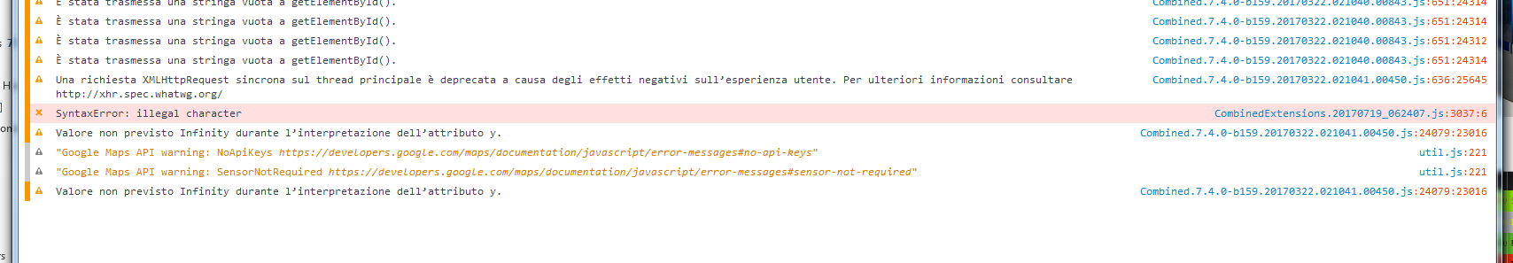

The message  on console panel  in firefox browser are the following
Many Thanks
BR
Dimitri
July 25, 2017
A custom widget that you have installed does not work correctly on Chrome. This is made clear by the SyntaxError in the console log.
Can you maybe right click on CombinedExtensions.20170719_062407.js (the red line) and select open in a new tab. Then attach the results here. This can help us understand which of the widgets causes the problems.

July 26, 2017
Looks like the chartWidget_ExtensionPackage that you imported was somehow messed up as it's contains invalid characters. Can you try to remove it and redownload it from another source?
