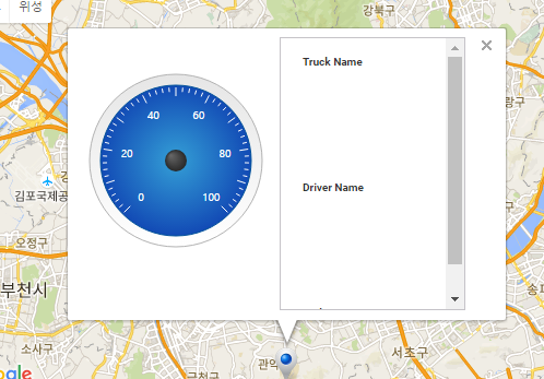

Could you please clarify what exactly you are trying to do or steps to reproduce?
If you are trying to pass parameters to your tooltip mashup from the main mashup, that wouldn't work. You'd need to pass the parameters either through the contained mashup or navigation/link mashup.
You may create mashup parameters in your tooltip mashup and then bind them either to a service or session variables.
jlee-711-VisitorAuthor
April 20, 2017
Hello Polina
Thank you for your answer.
Then, where I can use mashup parameters?
