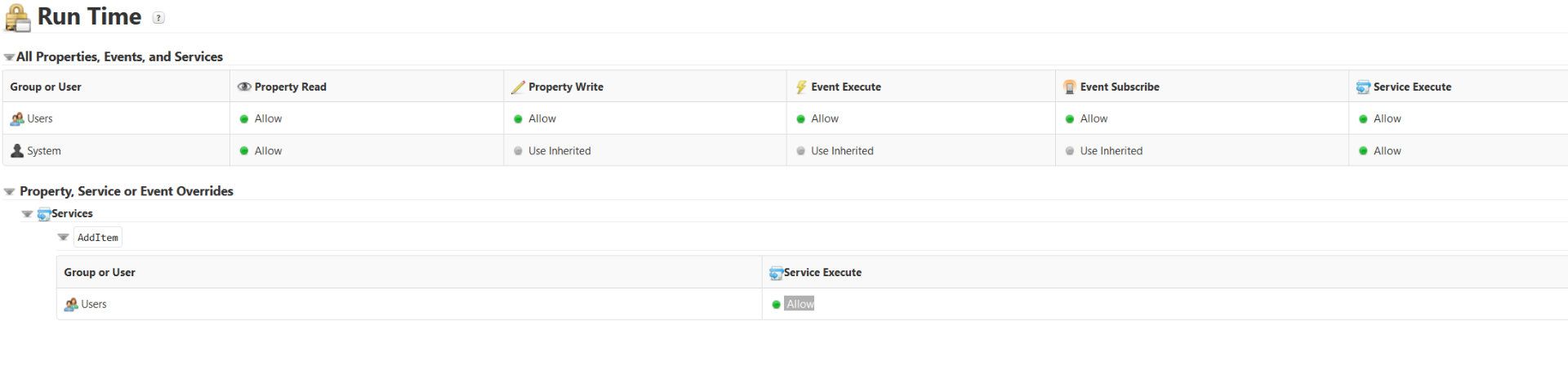

I set my permissions on stream like this:
  • Visibility Everyone
  • Runtime: Users (Property Read, Service Execute)
    • Services
      • AddStreamEntry

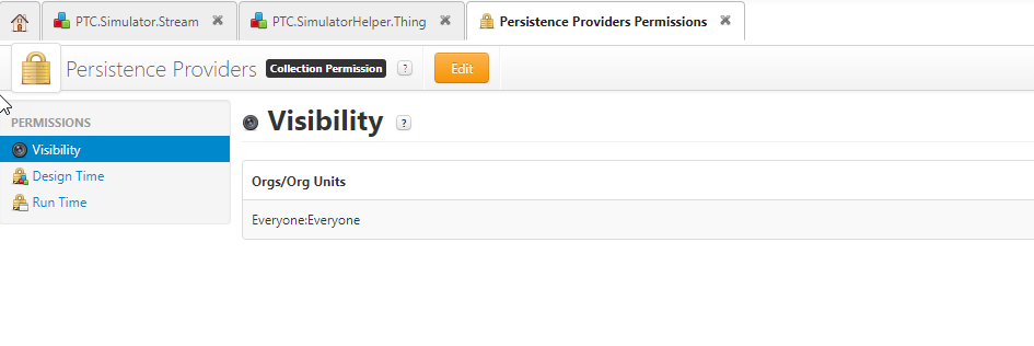

Best answer by rnayak-2
Fabio, Form your error log, The null reference to the stream indicates that there is a visibility issue here. Although you have given visibility access to the stream, you may have missed giving access at the persistence provider level. Go to persistence provider and add the User org there and see if it resolves the issue. Rest everything seems normal from what you have told!

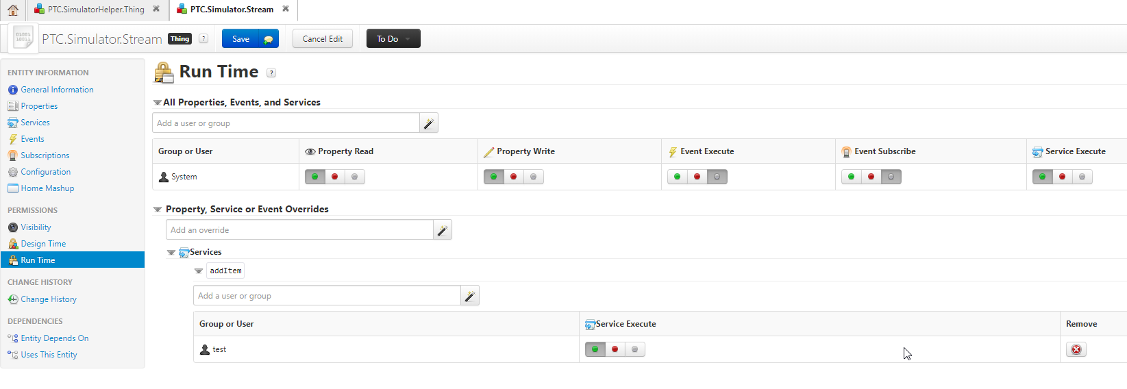

January 12, 2018
I know the questions maybe simple but this helps in getting an understanding
Can you show the permissions on the Stream and where the service is. Also as I look more at the code
can you add more debugging - where is the data coming from - I assume input params
January 12, 2018
Fabio,
Ragu is correct -  I simulated your issue and got the null pointer and was working the permissions and did not think about the visibility to the persistence provider. Version 8 by default takes visibility of everybody out of all collections
Below shows my configuration - Which I know you know - this just if anybody is reviewing the post
addItem service  permissions
Persistence Providers permission
January 12, 2018
