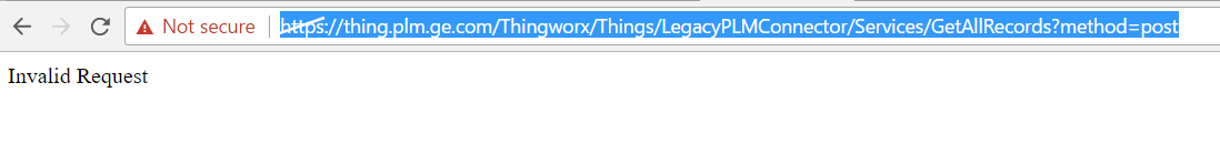

I have created a service called GetAllRecords.
The service is fetching all records from SQL db.
If i click Test button, the i am able to see the results.
But i am trying to see results in web browser by using below URL.
https://thing.plm.ge.com/Thingworx/Things/LegacyPLMConnector/Services/GetAllRecords?method=post
But it is saying "Invalid Request".
Any idea , whats going on here?
Thanks in advance.

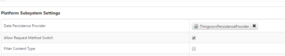

Best answer by posipova
Check that the REST API functionality is active.
Go to Subsystems -> Platform Subsystem -> Configuration from the composer screen; then check "Allow Request Method Switch" and uncheck "filter content-type".
June 13, 2017
Thank you. It worked perfectly.
