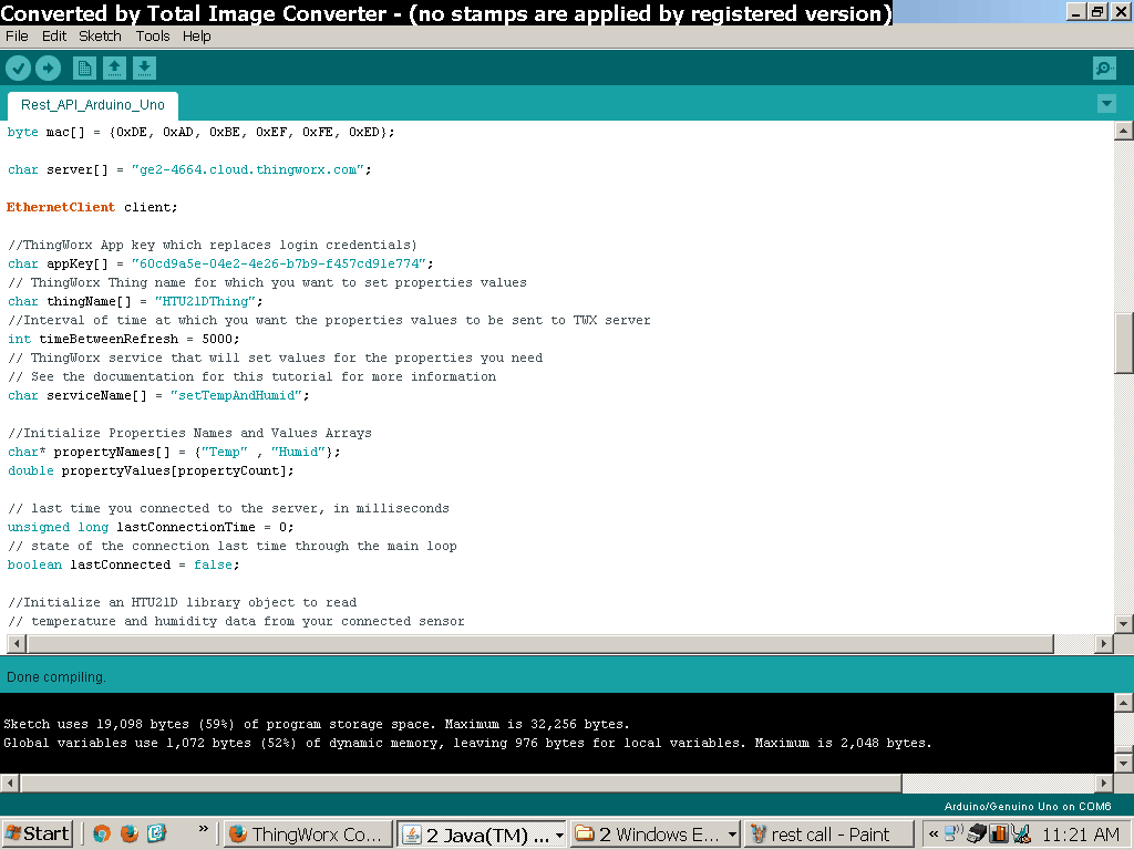

Unable to push the sensor output to the thingworx database

Presently i'm working on an example IoT project (Temperature and Humidity measurement using Arduino Uno), I got the sensor output using Arduino IDE but unable to see the output in properties section in the Thingworx database. I have followed all the procedures given in the instruction manual. And the second thing is i'm unable to find the Mail Server Template in the Thing Template. Can anyone suggest me, what might be the problem?
    Best answer by vmihai
    Can you please post a print screen of your Arduino IDE Serial Monitor with the REST calls that are being sent to ThingWorx ?

    dm-211-VisitorAuthor
    February 9, 2016
    February 9, 2016

    April 13, 2017
    Hi Veronica,
    I am facing the same problem. The serial monitor shows the correct POST method but the properties are not being updated.
    I am using the Composer 7.3.2.
    The code is:

          client.print(propertyNames[idx]);
          client.print("=");
          client.print(propertyValues[idx]);
        client.print(">");
        client.println(" HTTP/1.1");
        client.print("Host: ");
        client.println(server);
        client.println("Content-Type: text/html");
        client.println();
         client.stop();
        lastConnectionTime = millis();
        // print the request out
        Serial.print("POST /Thingworx/Things/");
        Serial.print("HTD11Thing");
        Serial.print("/Services/");
        Serial.print("setTempAndHumid");
        Serial.print(data);
        Serial.print("<");
        for (int idx = 0; idx < propertyCount; idx++)
          Serial.print("&");
          Serial.print(propertyNames[idx]);
          Serial.print("=");
          Serial.print(propertyValues[idx]);
        Serial.print(">");
        Serial.println(" HTTP/1.1");
        Serial.print("Host: ");
        Serial.println(server);
        Serial.println("Content-Type: text/html");
        Serial.println();
      else {
        // if you didn't get a connection to the server:
        Serial.println("the connection could not be established");
        Serial.println("HTD11Thing");
        Serial.println("setTempAndHumid");
        client.stop();
    Any ideas? I have read all information on internet and try everything.
    Thanks in advance!
    Felipe da Silva
