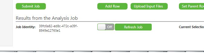

Unable to test Analysis model using thingworx analytics manager
  • September 21, 2017
  • 12 replies
  • 4880 views
I am following this tutorial https://support.ptc.com/help/thingworx_hc/thingworx_analytics_52/#page/thingworx_analytics_7%2Fthingpredictor%2Fthingpredictor-deployment.html%23
When I publish the model available in thingworx analytics to thingworx analytics manager, and provide the data in Test and press​ Submit job in thingworx analytics manager, I am getting the below error
Job was not found in runningJobs, could cause processing to stop
Please do let me know if I am missing something here.

September 22, 2017
Hi Christophe Morfin​,
ThingPredictor Agent is running. Below are the logs generated when I hit submit button in thingworx analytics manager in thingworx.
2017-09-22 10:46:19.556+0530 [L: ERROR] [O: c.p.a.c.s.BasicSDKConnector] [T: WSExecutionProcessor-11]
2017-09-22 10:46:21.579+0530 [L: ERROR] [O: c.p.a.c.s.BasicSDKConnector] [T: WSExecutionProcessor-12]
2017-09-22 10:47:53.918+0530 [L: ERROR] [O: c.p.a.c.s.BasicSDKConnector] [T: WSExecutionProcessor-13]
2017-09-22 10:47:55.972+0530 [L: ERROR] [O: c.p.a.c.s.BasicSDKConnector] [T: WSExecutionProcessor-14]
Below are the logs generated in thingworx predictor log folder
INFO  [2017-09-22 01:13:20,128] org.eclipse.jetty.server.handler.ContextHandler: Started i.d.j.MutableServletContextHandler@784d9bc{/,null,AVAILABLE}
INFO  [2017-09-22 01:13:20,138] org.eclipse.jetty.server.ServerConnector: Started application@65eabaab{HTTP/1.1}{0.0.0.0:9090}
INFO  [2017-09-22 01:13:20,141] org.eclipse.jetty.server.ServerConnector: Started admin@7123be6c{HTTP/1.1}{0.0.0.0:9091}
INFO  [2017-09-22 01:13:20,141] org.eclipse.jetty.server.Server: Started @23333ms
INFO  [2017-09-22 01:16:18,617] com.thingworx.analytics.ccc.data.datasources.JsonLocalDatasetSource: Received [1] rows to score
INFO  [2017-09-22 01:16:18,959] com.thingworx.analytics.scoring.core.predictive.PredictiveScoringJob: The model is not a time series model.
INFO  [2017-09-22 01:16:19,239] com.thingworx.analysis.TWAnalysisAgentAdapter: Completed synchronous scoring for [1] rows
INFO  [2017-09-22 01:16:19,239] com.thingworx.analysis.TWAnalysisAgentAdapter: Result of predictive scoring for the request PredictiveScoringRequest [modelUri=file:/D:/software/thingworx/MED-61217-CD-074_F000_ThingWorx-Analytics-ThingPredictor-7-4-0/ThingWorx-Analytics-ThingPredictor/./AgentWorkDir/TW.AnalysisServices.ThingPredictorConnector/Models/bearing_rul_Condition_368.xml, importantFieldCount=3, causalTechnique=FULL_RANGE, dataSource=com.thingworx.analytics.ccc.data.datasources.BodyDatasetRef@4b6bd1e6, goalName=condition] :
[[predictiveScore={condition=0.8478829789902185, condition_Max=0.9459829789902184, condition_Normalized=0.8478829789902185, condition_Result=0.8478829789902185, condition_ConfidenceInterval=0.0981, condition_Min=0.7497829789902185}, importantFields={time=0.9189298025133084, magnitude=0.08107019748669166}, errorMessage=null]]
INFO  [2017-09-22 01:17:53,607] com.thingworx.analytics.ccc.data.datasources.JsonLocalDatasetSource: Received [1] rows to score
INFO  [2017-09-22 01:17:53,607] com.thingworx.analytics.scoring.core.predictive.PredictiveScoringJob: The model is not a time series model.
INFO  [2017-09-22 01:17:53,613] com.thingworx.analysis.TWAnalysisAgentAdapter: Completed synchronous scoring for [1] rows
INFO  [2017-09-22 01:17:53,613] com.thingworx.analysis.TWAnalysisAgentAdapter: Result of predictive scoring for the request PredictiveScoringRequest [modelUri=file:/D:/software/thingworx/MED-61217-CD-074_F000_ThingWorx-Analytics-ThingPredictor-7-4-0/ThingWorx-Analytics-ThingPredictor/./AgentWorkDir/TW.AnalysisServices.ThingPredictorConnector/Models/bearing_rul_Condition_368.xml, importantFieldCount=3, causalTechnique=FULL_RANGE, dataSource=com.thingworx.analytics.ccc.data.datasources.BodyDatasetRef@54835f2, goalName=condition] :
INFO  [2017-09-22 01:21:16,648] com.thingworx.analytics.ccc.data.datasources.JsonLocalDatasetSource: Received [1] rows to score
INFO  [2017-09-22 01:21:16,649] com.thingworx.analytics.scoring.core.predictive.PredictiveScoringJob: The model is not a time series model.
INFO  [2017-09-22 01:21:16,654] com.thingworx.analysis.TWAnalysisAgentAdapter: Completed synchronous scoring for [1] rows
INFO  [2017-09-22 01:21:16,655] com.thingworx.analysis.TWAnalysisAgentAdapter: Result of predictive scoring for the request PredictiveScoringRequest [modelUri=file:/D:/software/thingworx/MED-61217-CD-074_F000_ThingWorx-Analytics-ThingPredictor-7-4-0/ThingWorx-Analytics-ThingPredictor/./AgentWorkDir/TW.AnalysisServices.ThingPredictorConnector/Models/bearing_rul_Condition_368.xml, importantFieldCount=3, causalTechnique=FULL_RANGE, dataSource=com.thingworx.analytics.ccc.data.datasources.BodyDatasetRef@60694bd, goalName=condition] :

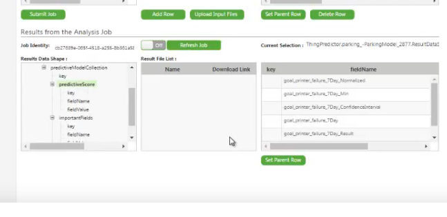

But I do not see the result of Predictive scoring below the Submit job button. I have attached the screen shot of expected(captured from tutorial video) and actual UI.
Expected
Actual

Hi Azim
From the log it seems that the job did execute and some prediction have been done.
So you might have a UI issue.
You have to note the following:
- the Test UI is not meant to be a fully robust one, it is only there for quick testing.
- in case it does not work you shoudl be able to get some result by populating the property of a Thign which are more what is expected to be needed in a real case scenario. See example at Video Link : 1817  around time 3:58.
- you can also try different browser to check if the display can be better
Kind regards
