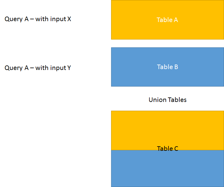

Hi all,
I'm trying to union two infotables in my service but get a "Wrapped java.lang.NullPointerException Cause: null" error when I do. In my service I want to run a single query a variable number of times with a changes in 1 input parameter and then union them together. I do not seem to be able to do it. The infotable columns are exactly the same since the results are coming from the same query. I have it in a forloop so that I can append it a few times depending on how many instrument types the user selects.
How do I get this to work?
thanks!
code below:

Lawrence,
Is this the exact code you are using.?
The first question I might ask myself could  rawData1 or rawData2  be null if the case statement does not find anything match?
I would create empty infotables for rawData1 and rawData1 to protect my code against null values
for example I usually place this at the top of my code for any infotables -  if I expect an InfoTable to be returned

lhui1-VisitorAuthor
September 28, 2017
That's exactly what I was missing. Setting up a datashape so that I could union my answers together even if some of them were null. Thanks Steve!
