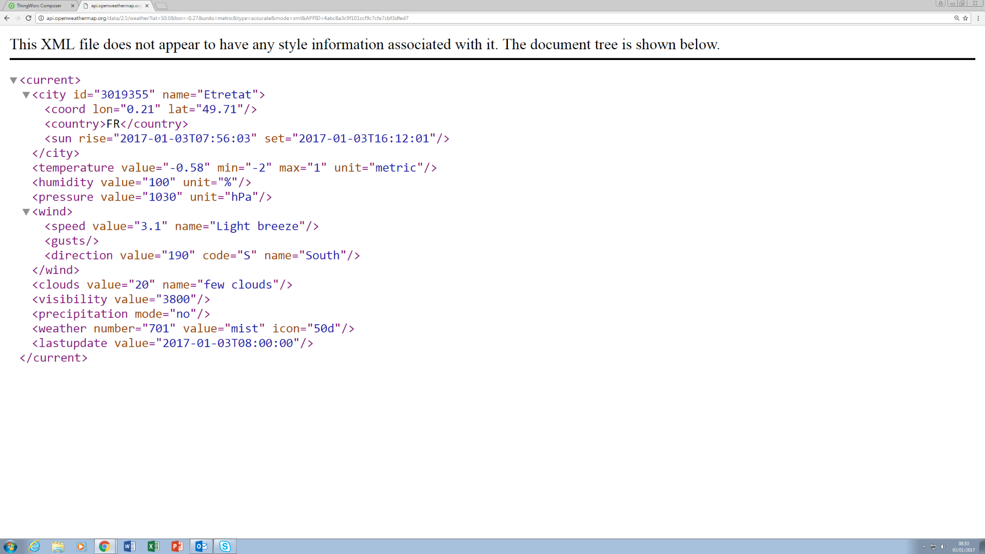

Hello, are you sure that your REST request returns information when run in the browser? I have seen issues with NaN just because the syntax wasn't quite right in the request. Also, are you sure you need those "@" signs in there? I have never seen this before when working with XML files.

Hello Tori
The rest request returns this in the browser. I copied the @ signs across from the weather tutorial and i'm not sure of their function. I assumed there were some kind of location marker for the value.
This XML file does not appear to have any style information associated with it. The document tree is shown below.

I copied the @ across from the weather tutorial. i have removed them now and tested the code. I still get NAN do you know what i would need for binding the xml values to a property? Does anyone have an example? Thanks for the help

adrianpet5-Regular MemberAnswer

msutton1-VisitorAuthor
January 6, 2017
Thank you Adrian that has worked perfectly and furthered my understanding of how to access the xml data and use info tables. Cheers Matt
