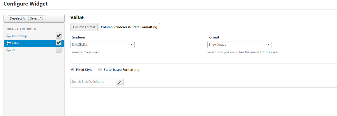

And I've set my rendering options to use 'imagelink' with format of 'show image' (both on a grid's columns and on a valuedisplay widget):

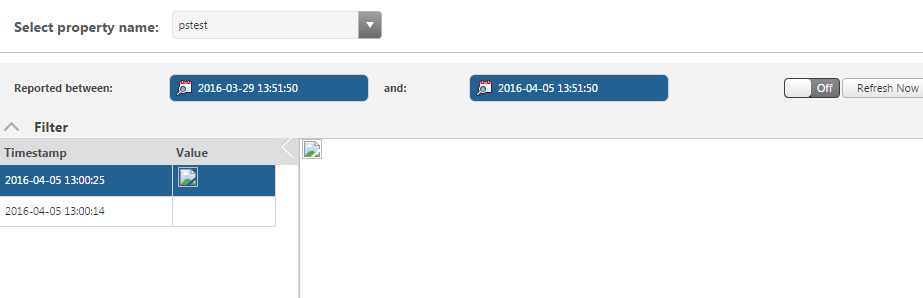

But yet what I see on my mashup are the broken link images:
I'm using TWX 6.5. Is this perhaps something that only works in later releases? Or am I overlooking a detail that is important? TIA.

Is the link to the image accessible by the Client machine?
