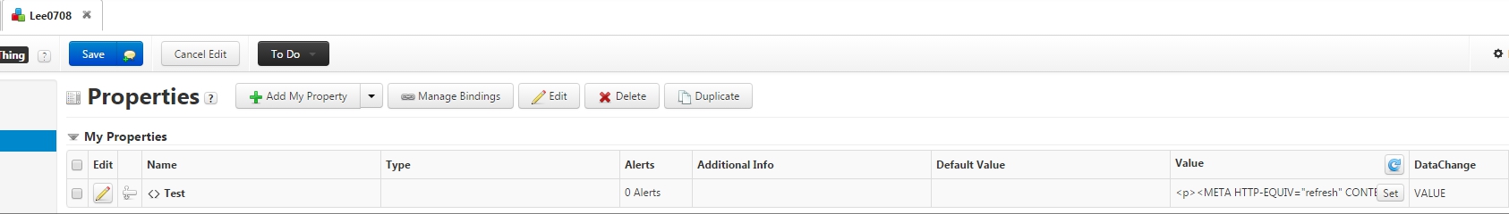

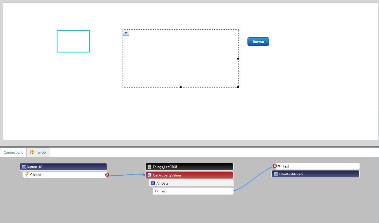

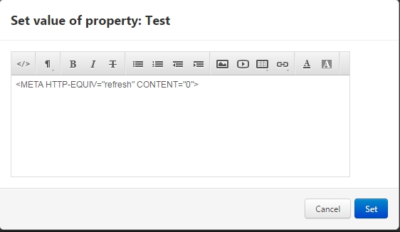

lwei1-VisitorAuthor
August 19, 2016
Hi, Tomas!
     Thanks for your comment! I've tried out the method you said, but it still can't work.
I followed the steps as you said, but it still can't refresh the page.
Is there anything that I missed?
