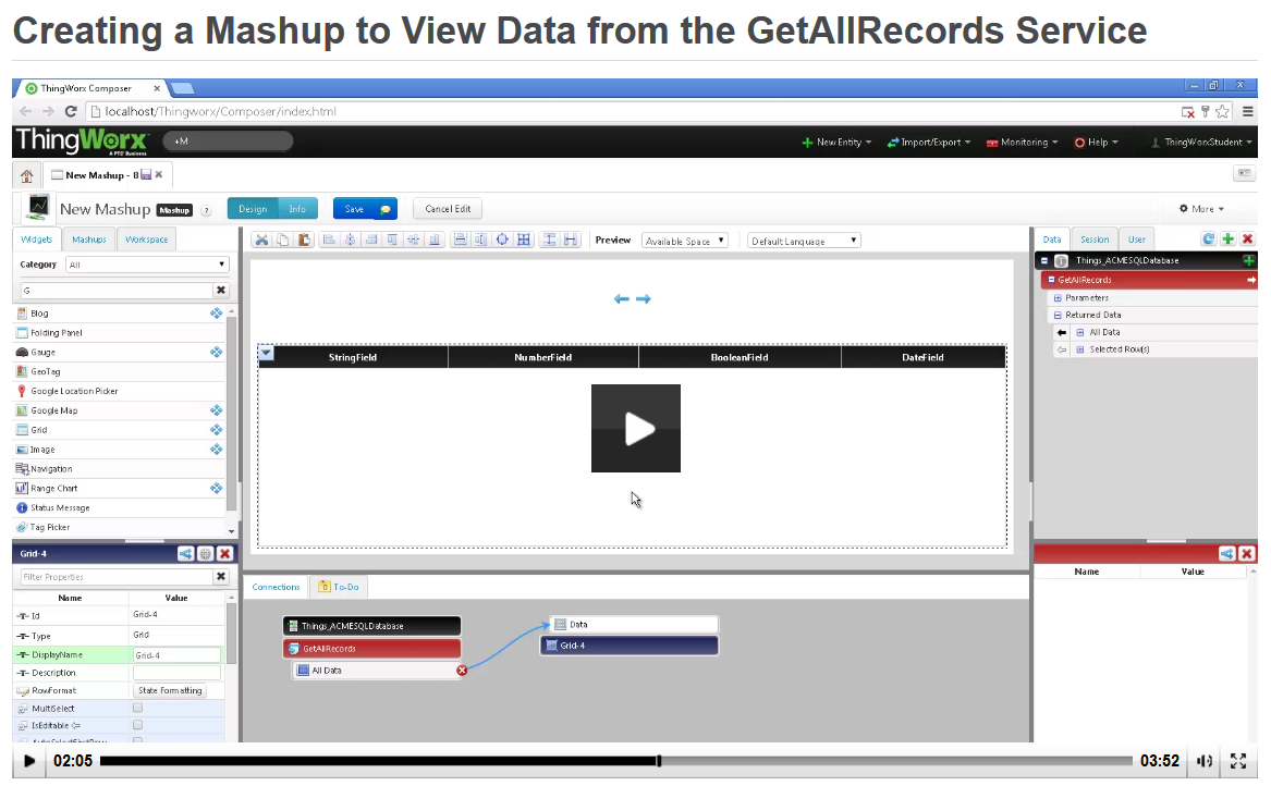

I followed the tutorial, which is the 'creating a Mashup to view Data from the GetAllRecords Service"
In this course, there is a view when the data was bound to the Grid Widget.

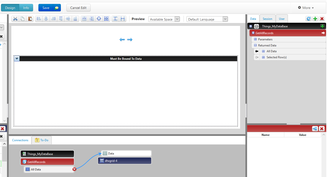

However, In my caes, The field name of  the data was not displayed. Did you know the reason for that?

Hi Kang, just to confirm after saving the mashup are you not able to see the values either when viewing the mashup? It could be that your service's output does not contain a valid Datashape? Could check or may be share the screenshot of the Service's Output section to check whether or not it has a Datashape assigned. If it has one please ensure that you have assigned correct DataShape to the service's result
