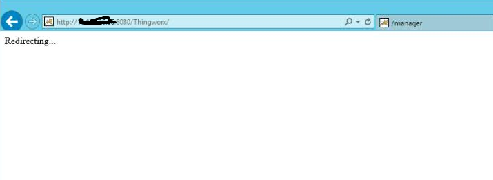

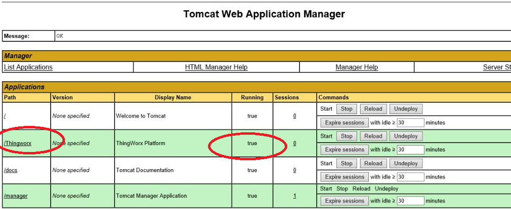

Our issue resolved after re installing of tomcat with new port.Now facing another issue.
We installed thingworx 8 on  cloud server.
from Tomcat manager page ,its  showing  Thingworx application as "running".
but when we are trying to access Thingworx URL from same server machine, its coming as "redirecting"..
Can you please help in resolving this.
attaching sceebshots for reference.
Tomcat manager:
Thingworx URL:
Raji.
July 20, 2017
Hi, Raji.
What database are you using as the persistence provider? Is it PostgreSQL, or something else? If Postgres, is it version 9.4.x?
-- Craig A.
