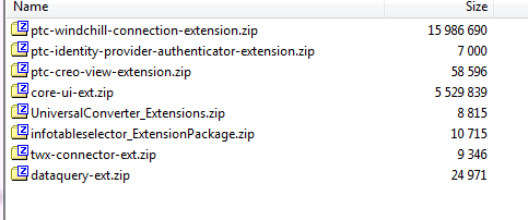

I am importing the whole "ptc-windchill-extension.zip" which contains these zips but I am getting the above error :
