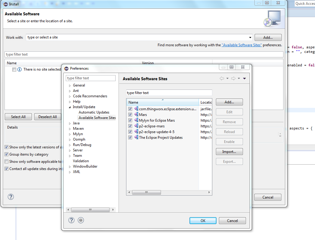

Hi Sai Kumar,
I got the same issue, You can resolve it by Go to Available software Sites and select all available softwares then OK then proceed.
I solved the same problem like this.
regards,
