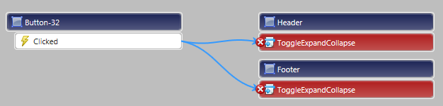

  • The Footer/ Header/ Sidebars are responsive, so they can hold a Grid widget directly (Many columns)
  • The Footer/ Header/ Sidebars can be bound with a button, and clicking the button to activate the ToggleExpandCollapse service, making it "The list of rows can be opened and closed like a dropdown"
  • It can overlay all widgets when opened
