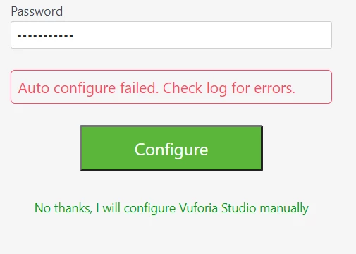

Cant login in the portal
I Can't login in the portal Login. But in the project, appears a pop for login and it works and I can publish the project, but the thingmarks doesnt appear, says to go to login in the portal but doesnt work.  imagem.png

Hi @RG_10241848,
Are you using On-Prem ES server or Trial ES?
The portal login is only for Vuforia (Trial) - https://trial.studio.vuforia.com/home/
The error appears to be network issue - try configure from a non-corporate network environment
If you can publish project, it sounds to me you are using On-Prem ES.
In that case, you will need to request for ThingMarks via Support Ticket.
See below article for how to request for ThingMarks:
https://www.ptc.com/en/support/article/cs256044
