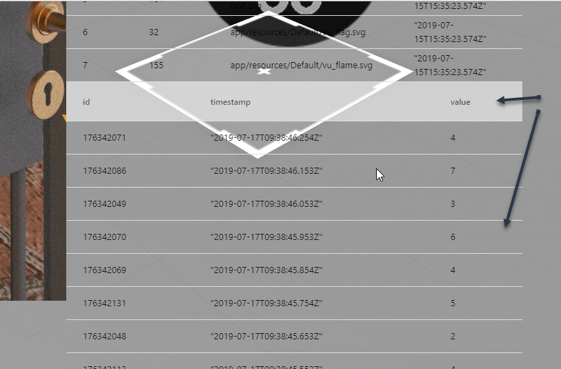

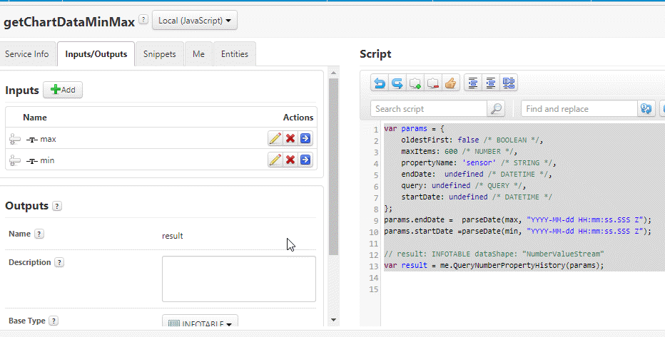

In this topic is shown the case  when you have a value stream with values and timestamp. In the mention topic the value are shown  in a DataGrid widget but the principle is the same. So the clue here is that we can define a service  for particular property Name and  using e.g. as Input StartTime and EndTime ( fromat "YYYY-MM-dd HH:mm:ss.SSS Z")
We can call this service from Studio to get the desired data for a property and for a defined  time range:

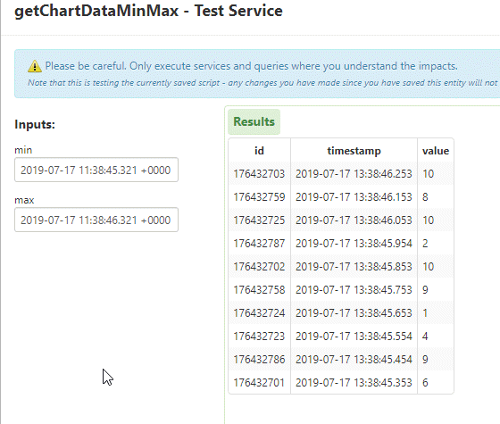

Here example for test in Thingworx:

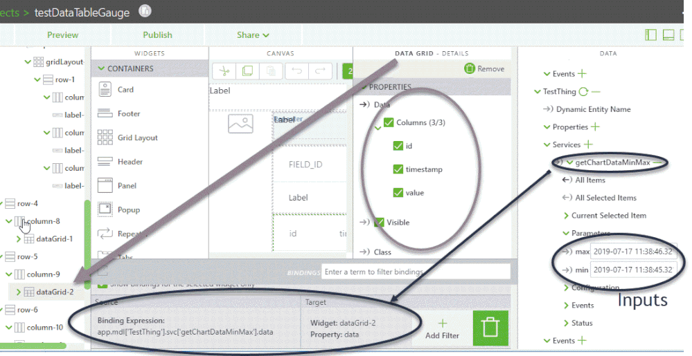

And bind the dataGrid Widget data to service getChartDataMinMax in Studio:
And thest then in preview mode:

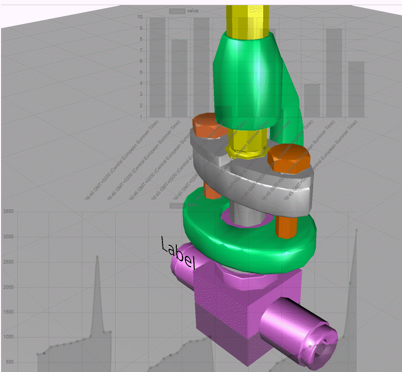

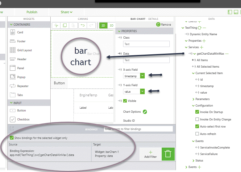

Additional here example how to use the mention service getChartDataMinMax (here with default service values) for a bar chart widget:
and the display in preview:
