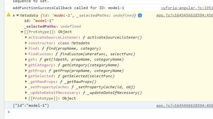

Hi @GianVal ,
I think the meta data API as documented in the Help http://support.ptc.com/help/vuforia/studio/en/#page/Studio_Help_Center%2Fcad_metadata_api.html
could not be used in 2D view. But you can download the JSON file correspoinding to the PVZ to the Upload  project folder or to a string variable via TWX LoadJSON service . In this case you can  use some old techniques as described in first section  of the tech tip https://community.ptc.com/t5/Vuforia-Studio-and-Chalk-Tech/Incorporate-CAD-Metadata-Into-an-Experience-version-8-5-13-and/ta-p/693341
Further when I tes some code like this:
$rootScope.$on('modelLoaded', function() {
 PTC.Metadata.fromId('model-1').then ((metadata) => { console.warn(metadata); console.log(JSON.stringify(metadata)) })
this will print in the console
so seems that this object of the meta data with api methods is not so easy to be importetd as json to the project. (my opinon after first look) otherwise each javascript structure could be imported as text and then converted with eval function- when we know the exact code 😊
