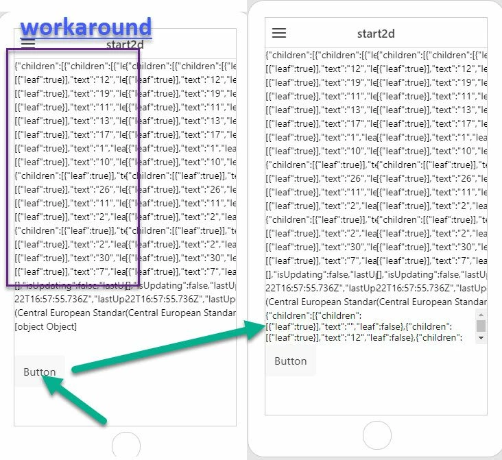

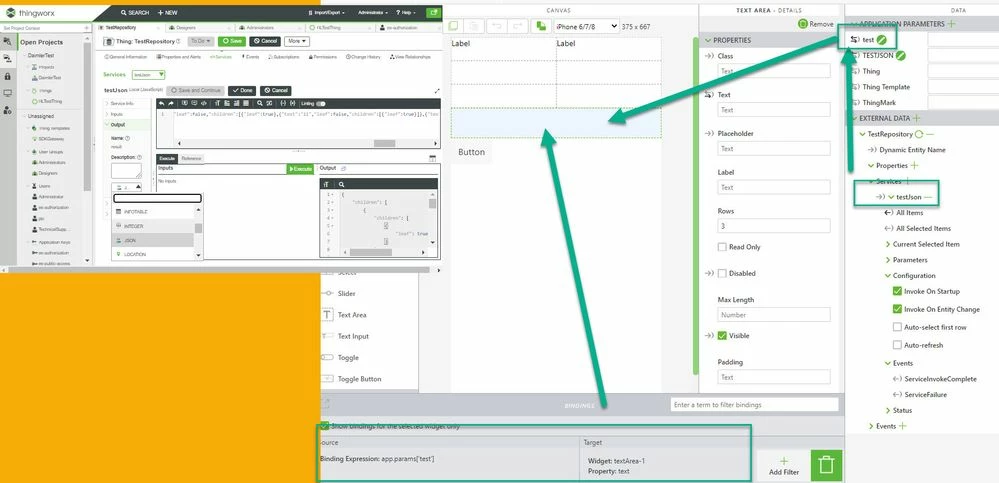

Jan 22, 2021 5:26 PM UTC
Yes , I could reproduce this issue. Strange. I think this seem to be related that there is some delay when the JSON service is called so that when the parameter is initilized . For example when I test the following:
In this case the issue could be reproduced but  when some times later we click a button (button JS Box will call test() ) This  will set the data to the  parameter - then this works fine. Following sample code:
$scope.test=function() {
console.warn($scope.app.params['TESTJSON']);
 $scope.setWidgetProp('textArea-1','text',$scope.app.params['TESTJSON']);
So now when we click the button ->  data is passed fine to the applicaiton  parameter test and the parameter has also binding to the widget and the value is passed correctly form the parameter to the widget. Therefore I susspect that this is some issue  based on service delay where the value is not converted and passed  correctly
So if you want to set a parameter with a JSON data which comes form TWX service -> the following workaround could be use /one possible option :
// this function will set the data to the parameter
// the function is called after the view is entered
$scope.init=function() {
 let result=$scope.app.mdl['TestRepository'].svc['testJson'].data;
 console.warn(result)
 $scope.app.params['TESTJSON']=JSON.stringify(result);
 $scope.$applyAsync();
//event which will call the function with a delay on start
$scope.$on('$ionicView.afterEnter', function() {
 $timeout(() => {
 $scope.init();
 },500)
// this will set manually the value form parameter to widget
Here the values are set with some delay
