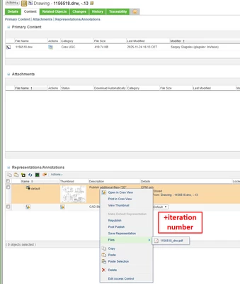

Use Case: Hello, I am looking to see if its possible to add the iteration number in the file stored in the representation;. We downloads the PDFs and steps files thru so it would be helpful to have the iteration also showing to reduce the chances of mixing up.

I believe this is what you want.
https://www.ptc.com/en/support/article/CS349681
November 25, 2025
