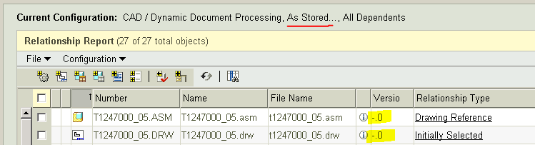

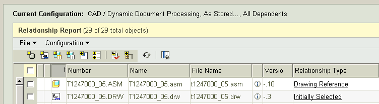

Can someone please clarify how I list the 'as stored' version of a drawing's references?
For assemblies I can use the structure browser. For drawings the only thing I'm seeing is the References section of the Related Objects tab. Unfortunately this only shows the Latest Version.
I can manually add the drawing to a workspace with the config spec. set to 'as stored'. There has to be a way to display this without adding to workspace.
This is with Windchill PDMLink 10.2 M020. Thanks.
Best answer by TomU

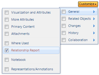

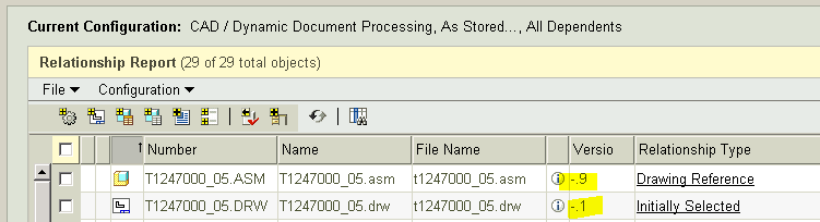

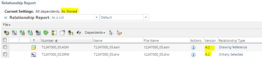

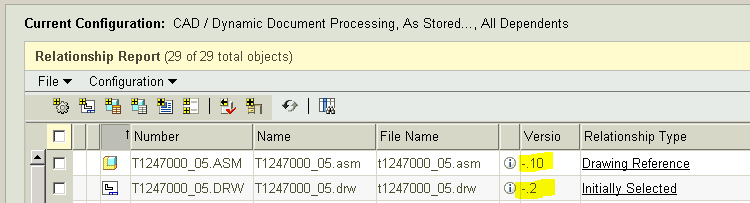

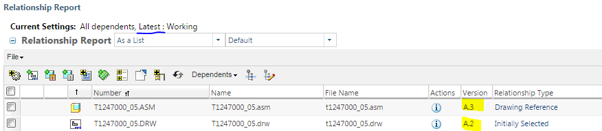

Found it!
I was sure I could do this in 9.1. So sure I went back and fired up our old system just to remember how. It was the "Relationship Report" tab.
Take a look at the attached pictures. Notice how, when using the 'as stored' config spec., each drawing version lists is corresponding model version.
It still exists in 10.2, but has to be manually added to a new tab. It's not visible by default out of the box.

TomU23-Emerald IVAuthorAnswer
November 6, 2014
Found it!
