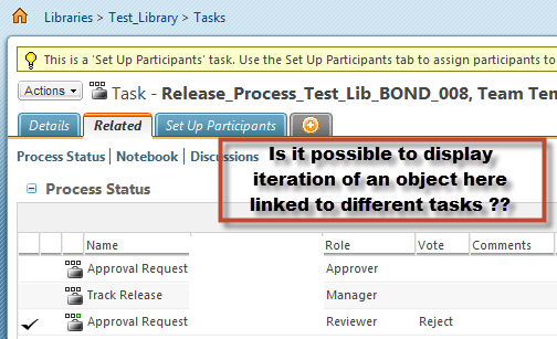

Hello Antoan,
Thaks for your reply,
Athmanand
November 10, 2014
Hello. I wrote you about instruction field in the Details tab.
