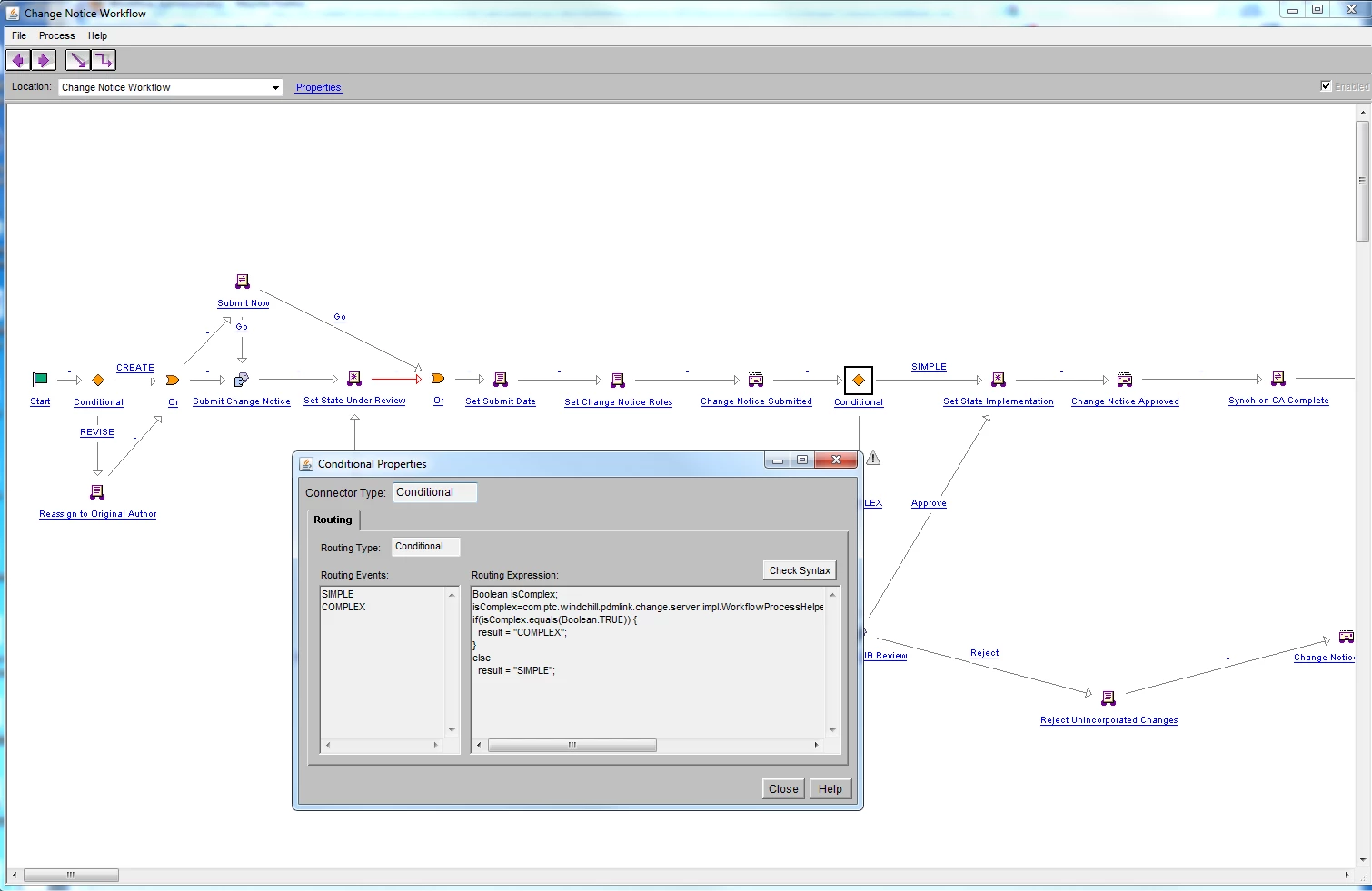

Well CMII indicated that 80% should be fast track. It is used to
determine if the workflow routes to that CIB task. Its supposed to allow
complex changes to get a more complete review. Its up to you if you want
to use it.

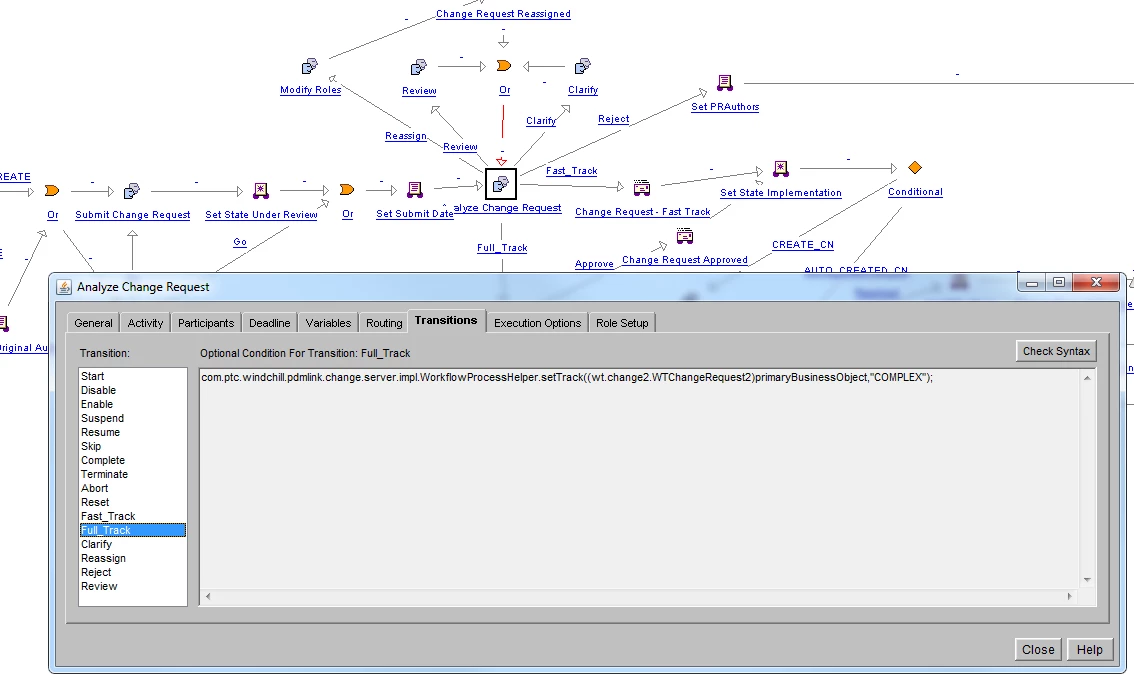

The track attribute is set in the Change Request Workflow in the
transition (note there are screenshots that the Forum might append to
the bottom of the email as attachments)
When I was a customer we used these methods to allow the Change admin to
reassign the track at certain points if the CCB decided it was
mis-scoped.
And evaluated in the Change Notice to determine the workflow path
