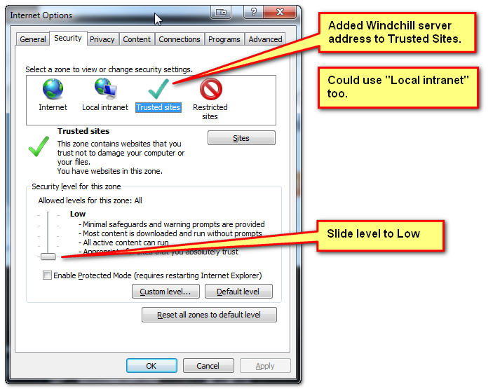

18-Opal
October 7, 2014
We had to add our Windchill address to the "Trusted Sites" list in IE and set the security slider to Low to get it to behave.
We have used the Local Intranet settings with success as well.
On IE 10 and IE 11 sometimes the compatibility settings need to be tweaked. I know it isn't officially supported, but that doesn't mean it wont work. Just riskier.
October 8, 2014
If you prefer, you can keep the security setting level at Medium and just make the following change:
Put <windchill server url> in the trusted sites list, reset the settings to medium and then make the following single custom level change:
"Allow script-initiated windows without size or position constraints" set to Enable

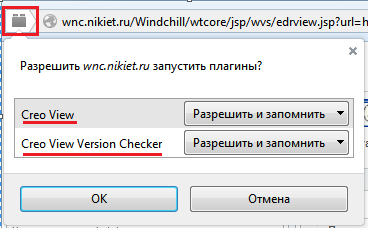

Go to the Quick Links/Software Downloads and try to reinstall Creo view. When you will start CV first time you should be correct when the browser asking you.
If you are working through Firefox open CV window and press on the plugin icon. Then check the plugin permissions.
Sorry for russian language in image. I guess you understand me )
