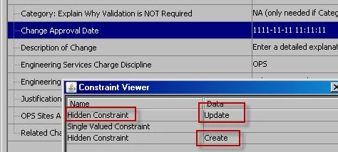

September 14, 2010
We have this set up at several places..
In Type and Attributes manager.. here is how you would hide them.
[cid:529495716@14092010-0C78]
Preeti
