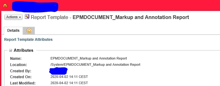

MarcoTosin
Apr 2, 2020 12:18 PM UTC
I have just imported the qml in my test system (11.1 M020)
See attached
Marco
