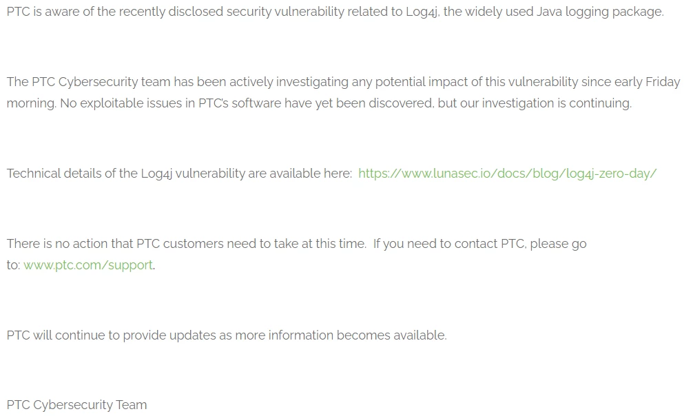

Just opening this thread as I haven't seen it anywhere else. Have the been any talks about the log4j exploit and Windchill? We are on Windchill 11 so I would assume we are open to the vulnerability but haven't seen anything mentioning it anywhere on PTC's sites. Just looking to get ahead of this in any way possible.
Figured I would open this thread publicly instead of a support case as it is affecting everyone.
Dec 11, 2021 6:08 PM UTC
Hi @ErikZabokrtsky .
As @ScottMorris reponsed, PTC is aware of the issue and our cyber security team  has been actively investigating any potential impact. As of now, no exploitable issues in PTC’s software have yet been discovered, but our investigation is continuing.
Please refer to this mini-site in order to get the latest updates on this investigation.
In case of any issue or doubt, please contact our Technical Support team.
Thank you.
--JC

PTC Technical Support Repose:
PTC R&D team and Security Team are actively working on priority for Log4j2 vulnerability CVE-2021-44228 reported.
The log4j version used by Windchill can detected by referring article. https://www.ptc.com/en/support/article/CS358667
PTC Security Experts will roll out an official communication soon about this CVE, its impact for customers & the next actions soon.

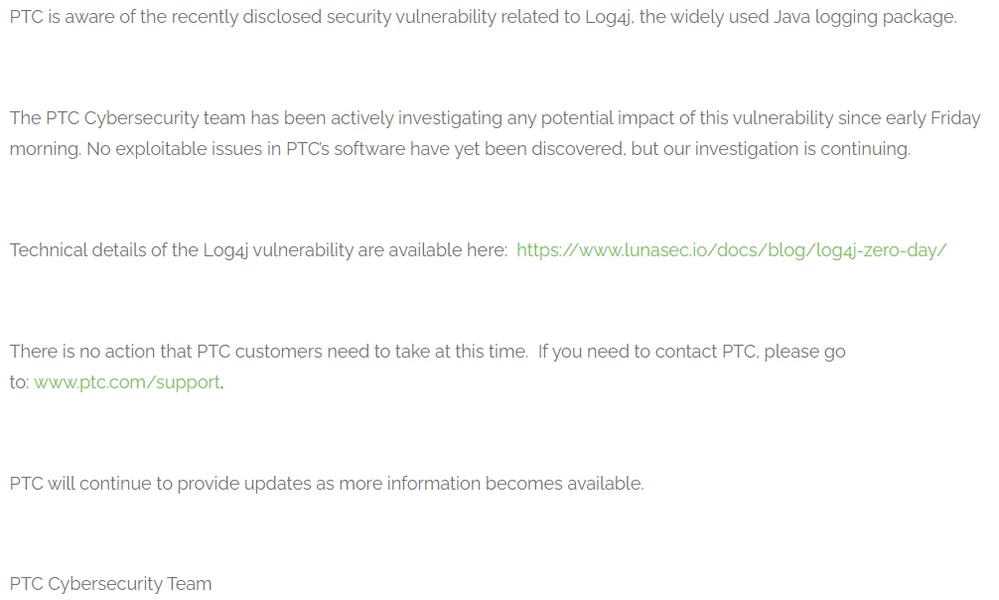

Thank you.
--JC
