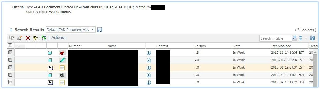

I also don't think you can execute searches based on deleted users too. So, for example, I cannot search for "CAD files" created by "Steve Vinyard" between "date1" and "date2". Isn't that true?
Ben
September 15, 2014
Searching by deleted user works just fine. (10.2 M020)
