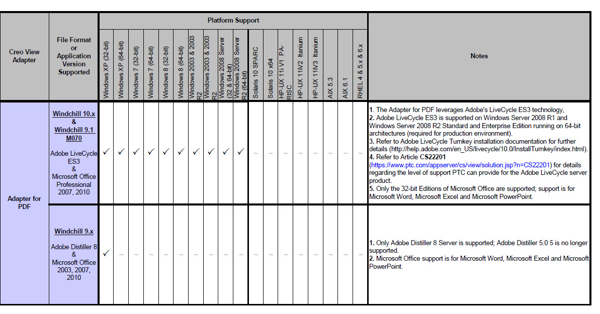

Best answer by LoriSood
Based on the first line in the worker_0.log you're using the 2.0 M040 adapters:
doc2pv - Version : Creo 2.0 - M040 (13.1.40.15) i486_nt
If Anton's suggestion doesn't help try disabling the DTI properties option: Enable Merge in the recipe editor's Advanced> Miscellaneous section.
Please be aware that if you're running Windchill 10.0 or later Distiller is not supported for use with the Adapters:
http://support.ptc.com/WCMS/files/151924/en/CVAdapters2.0M040_42414.pdf

Pavel,
What version of the Object Adapters are you using?
If you enable verbose workers in the Worker Agent Administration (under Site > Utilities), restart the Doc worker and republish do you get any further output in the worker_#.log generated on the CAD worker?
I am assuming that you're doc worker utilizes the Adobe LiveCycle Server. The version used there along with the jboss log could also be helpful here.
Lori

No we don't use Adobe LiveCycle Server.
Seems to be a problem in Adobe Distiller.
September 8, 2014
1. Go to the "printers and devices" window. Right click on your PDF printer, select "Adobe PDF Settings" tab and unmark the "Rely on system fonts only; do not use document fonts" checkbox.
2. Go to the Control panel/Programms and components. Right click on Adobe Acrobat 9 StandardEnglish, Fransais, Deutch and select "Modify". Press "Next". Select "Modify" and press "Next". Select all subcomponents and make installation.
