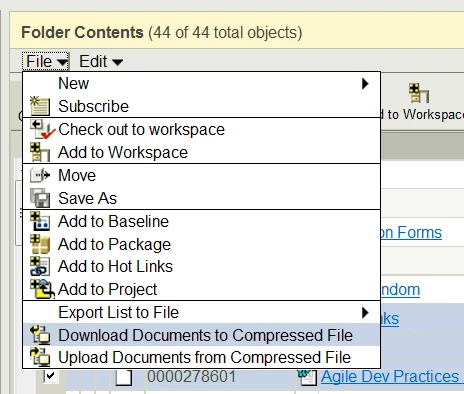

Not sure if this helps but if you can select them in a container then you can create a zip file of those documents by clicking on File->Download Documents to Compressed File.
