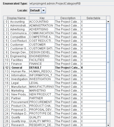

Is it possible to edit the list of categories presented in the Categories list for a project? If so, how is it done?
Jon
22-Sapphire I
November 2, 2011
- Windchill shell: enumcustomize
- Browse to: /wt/projmgmt/admin/ProjectCategoryRB.RB.ser
Edit as needed
Resource build

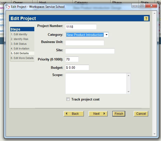

ProjectLink Admins,
We are setting up a new project template in ProjectLink and we want to add a new category (2nd field in step 4 of the project creation process) . Am I able to add a new category to the list?
We are using Windchill 9.0 M060.

January 27, 2012
Add to the resource bundle (rbinfo file). Use Enumcustomize from a Windchill shell, rebuild .jar files.
