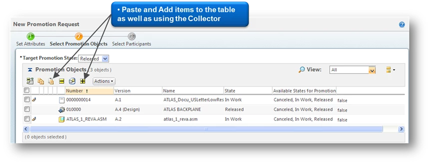

You will also notice that you cannot Promote objects that are not related and usually this is the case on an ECO, I filed an enhancement request, or I mean into the black hole. There is a kinky work around, let me know if your interested.
May 12, 2011
The ability to add or paste items to the promotion table is part of 10.0

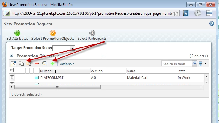

May 13, 2011
Jeff:
Will Intralink 10 get the ability to add / remove items from an existingpromotion list? This is a particular pain point for me as I frequently have to delete then recreate promotion requests if they are missing items, need corrections to a drawing, etc. I was told that this capability was only available in PDMLink.
We're on Intralink 9.1
May 13, 2011
Andrew,
The Promotion Request functionality is no different between PDMLink and
Intralink. Here is a screenshot from an Intralink 10.0 server
May 13, 2011
Jeff,
I believe Andrew means as part of a Workflow... as a Downstream Approver can he Edit the Promotion Request and Remove Line Items or Add Additional Line Items.... (Similar to how Change Task will allow)
Brian S
