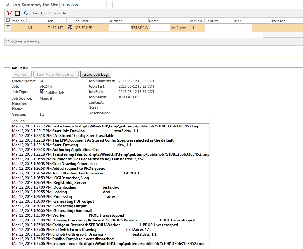

I am having problems with some of my publish jobs timing out on thumbnail creation. If I go to the cad worker, I am seeing the thumbnails but they are not making the trip to the Windchill server. In the job monitor log I get that the worker was stopped. (screenshot attached to this)
I am curious if anyone else has had this issue.
Thanks id advance.

March 12, 2013
Brian,
Yes, I sometimes get the same error, but only with really big models (4000+ parts). I have tried increasing the adapter timeout, but is has not fixed the problem. We are running 10.1 M010 (at the moment, updating to M030 in the next 2 weeks).
Mike
March 12, 2013
There is a setting in the recipe file that you need to change. It's on Advanced > System I believe it's the Short Timeout Helper.
The knowledgebase had the exact error from the publish monitor, and told me which one to change.
Currently I have Short Timeout Helper set to 300 and Long Timeout Helper set to 3600.
This fixed the same issue for me.

March 12, 2013
Thanks everyone for the suggestions so far!
I should mention that this is happening most of the time on our drawings. These drawing are the master for our larger assemblies. Now the drawing generally only contain an empty simplified reps but the number varies on how many objects it says it pulls workspace but it is anywhere from 650 and up. I have tired including a view to see if that helped but it does not.
So here are the recommendation/suggestions so far. Some/most of which I have already tried. See below for my comments/questions. Still broken for me....

March 12, 2013
We were seeing this error only for drawings and they were larger drawings typically 900+ objects. After changing the setting that I posted my issue was resolved.
What is the error message in the Publish Monitor for that job? Can you post that?

March 12, 2013
We also has the issue with large drawings 436 objects + 34 Sheets
PDF file was 58 Mb.
The error show up on the cad worker machine
Creo(R) View - pvsthumb.exe has stopped working
A problem caused the program to stop working correctly. Windows will close the program and notify you if a solution is available
When installing the plugin for adobe you will get an message “Failed to install acrobat plugin” if you have the wrong version of reader.
Ray D.

byork17-PeridotAuthor
March 12, 2013
Steve,
I have mine set to 600 for the short and 3600 for the long timeout.
Here is a typical log.
[cid:image003.png@01CE1F2D.56F77390]
Brian
March 12, 2013
Brian,
I was logged on to the cad worker machine and it showed up on the desktop when the job timed out.
Ray
