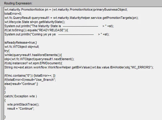

I am looking for a way to query a particular attributes value of an object attached to a promotion request. We are using Windchill 10.0 M040 and will be updating to 10.1 M030 this weekend.
For example, we have a custom boolean attribute (CertificationControlled)attached to the DefaultEPMDocument object type, and we need to know when objects with that value set to 'Yes' are submitted for promotion within a Promotion Request. I can loop through the objects attached to the promotion request object, but I am not sure how to get the attribute value and check to see if it is true or not. Any help will be appreciated.

We do exactly this for the ModelCheck errors (which we label as MC_ISSUES in the info page) attribute using the code shown below.
[cid:image001.png@01CEE6C9.15DB4670]
[cid:image002.png@01CEE6C9.15DB4670]
[cid:image003.png@01CEE6C9.15DB4670]

We don't have the ext.alcon class. Is that custom? What version of Windchill are you running? We are on 10.0 M040.

How do you use the LWCNormalizedObject class within a promotion notice? I need to query the IBA values for promotion objects stored within the promotion notice object.
I have the following syntax, within an Expression node, which is working nicely, but I cannot seem to get the IBA value for an attribute associated with the object found during the iteration while loop.
promotionDescription = pn.getDescription().toString();// store the text found in the promotion request description attribute
wt.fc.QueryResult pn_targets = (wt.fc.QueryResult) p.getBaselineItems(pn);
Object myObject = pn_targets.nextElement();

I have LWCNormalized Object API in your code to retrieve the IBA value. Check if it works for you
wt.maturity.PromotionNotice pn = (wt.maturity.PromotionNotice) primaryBusinessObject;
promotionDescription = pn.getDescription().toString(); // store the text
// found in the
// promotion
// request
// description
// attribute
wt.maturity.StandardMaturityService p = new wt.maturity.StandardMaturityService();
while (pn_targets.hasMoreElements()) {
String objType = myObject.getClass().getName(); // get the internal
// name of the
// parent object
// type
if (objType.equals("wt.epm.EPMDocument")) {
isCAD = true;
epmObjType = objType.toString();
com.ptc.core.lwc.server.LWCNormalizedObject obj = new com.ptc.core.lwc.server.LWCNormalizedObject((Persistable) myObject, null, Locale.ENGLISH, null);
if (objType.equals("wt.doc.WTDocument")) {
isDocument = true;
docObjType = objType.toString();
Hope this helps !!!!

Thanks for the clarification on seeds vs. targets. From what I can tell, in the Windchill 10.0 JavaDoc, the getBaslineItemsmethod is still available, but you access it via wt.maturity.StandardMaturityService. There is a getPromotionTargets method within the StandardMaturityService class that is used for just accessing the targets. I have updated my code, now, to use that method instead.
