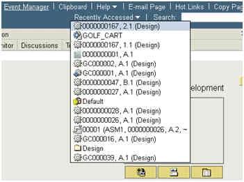

Has anyone worked on customizing the Recently accessed objects list in Windchill (see attached picture)?
I would like to add name and lifecycle state to the objects display.

Look into writing a DataUtility for this. That should control how that
list is displayed. You should be able to alter it. Remember, not all
items in that list have name and state. Folders do not have state. Also,
it could get very long. Things to consider.
