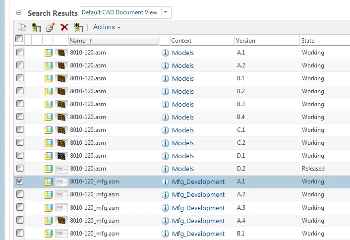

Ok so this was possible in ILINK3.4 how do you do it in WC10. See picture below. I would like to delete 8010-120_mfg.asm version A.1 from the data base. Unfortunately I cannot I can delete A.4 through A.1. Purge is not the answer. I do not want to delete from A.1 through A.3 and leave only A.4 I would like to selectively delete these items from the database.
Ron
[cid:image001.png@01CDBC07.911FDD70]

Typically, I would suggest that non-engineering personnel shouldn’t have access to non released parts. If it’s WIP, only engineering has access.
If there are other departments that need to see parts that are not released yet (like purchasing dept for long lead-time items), there should be a separate life-cycle state the files can be changed into to give those people access.
Now, the problem with leaving the WIP objects in place becomes when a future revision takes place. You can’t really rely on every engineer to remember that one item at WIP should not be used. The solution is more involved.
The first solution to try is to delete the newer iterations back to the released version, which you've already tried.
After that, I would open the released version (part/assembly and drawing), then update my workspace. When prompted to update the work in session, pick NO. Check out the offending files (again, part/assembly and drawing) while in your workspace. Now when you save the files in session (the released files), you'll overwrite the "bad" files with the latest released version. Check in, put a comment into the check in field explaining what you did, and leave it at that.
In this way, in the future when an engineer searches for that file, they will see the WIP version, but it will match the released version, rather than all the changes that are now obsolete.
There may be other ways to get around this, like involving tech support, where you can sort through all these build rules violations. I've simply never taken the time to research it further due to how quick the above method usually ends up being. It's really up to you to decide which is the best for your organization.

Maybe it's just me. I'm still having trouble understanding why we care about some random iteration in the middle of a series of iterations that we want to keep.
A.1 --> A.12 (final one Released)
B.1 --> B.12 (final one Released)
C.1 --> C.12 (all at WIP)
If I'm understanding correctly, the origianl request is to delete something like C.3.
Why?
Who cares that it exists?
It's not the released file being used for production.
It's not the latest of Rev C, so engineering won't be using it for new design changes.
The whole request seems rather like a random nitpick.
(There have been explanation for needing to delete all of Rev C (iterations 1 through 12) and the system restricting that deletion. This I understand; a revision is requested then sometime later that request is rescinded.)
