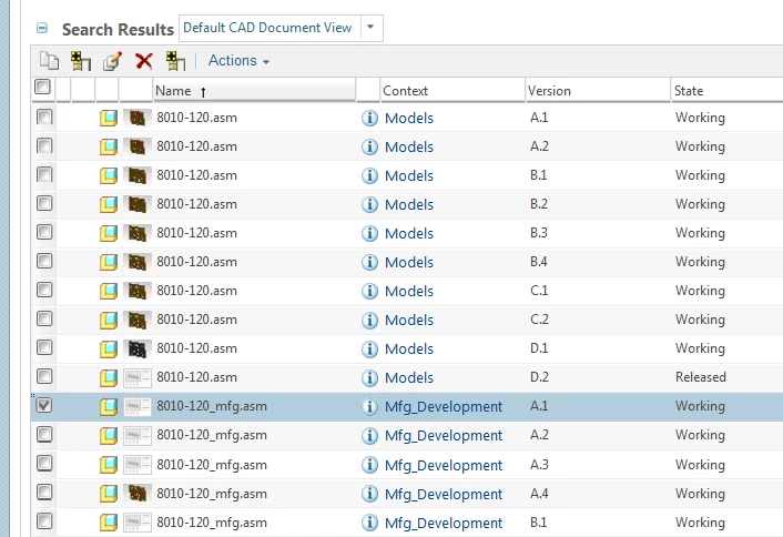

Ok so this was possible in ILINK3.4 how do you do it in WC10. See picture below. I would like to delete 8010-120_mfg.asm version A.1 from the data base. Unfortunately I cannot I can delete A.4 through A.1. Purge is not the answer. I do not want to delete from A.1 through A.3 and leave only A.4 I would like to selectively delete these items from the database.

You have the following:
1- Massive Relational Database structure with links to everything (Change Models, Promotion Requests, Secondary Content, Multiple Visualization files for each object, IBAs, etc)
2- CAD Models with parametric information that is also managed, controlled and protected by the database/Windchill
3- All history is meticulously maintained automatically
4- All data integrity is maintained including rename operations etc.
5- All CAD Models are stored with an As-Stored configuration automatically (a baseline) that can be referenced at any point in time to see EXACTLY how a model was built, rev for rev, 15 years ago.
You don't have:
1- The ability to delete a historical revision very easily
[cid:image002.gif@01CDBDBB.E9DC5F00]
Steve Vinyard
Application Engineer

If the iteration has no links to anything else (highly unlikely), then
I'm pretty sure you can delete it (as admin). (Been a long time since
I've done so).
More directly/importantly though, when I've been asked this question in
the past, my response has always been to ask why you want to delete old
iterations?
Typically the answer comes down to wanting a "clean database". i.e. some
attempt to keep the house clean so guests don't see how messy life is
(can be). Or about file server space.
Having a clean house can be done with states, upon release, set all the
in work stuff to history (or similar) and only let admins or such see
history items.
File space should not really be an issue, the incremental cost for data
storage in a well configured datacenter is very inexpensive (less than
$1000/TB).
The only issue IMO is in database/metadata/table size. And here, Oracle
has solutions for extremely large databases (larger than I've ever had
to worry about). So may require more Oracle expertise than we normally
use in the WC world, but I'm confident it is manageable.
As for legal questions, I'm involved in two federal cases as an expert
witness, and if missing files (intermediate iterations) are not there,
it causes questions and problems in the legal world. Missing iterations
cause concerns from both legal parties, even if explained as clean-up
etc. Now, if the database contains files that were illegally obtained,
there is a lot more that needs to be done than just deleting the native
file and no application should allow such to be done through any user
interface.
~Dan
