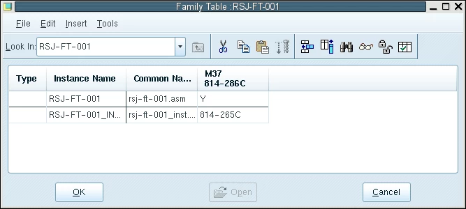

This screenshot shows the family table with the correct component name (814-265C[.asm] in this case).
family table correct

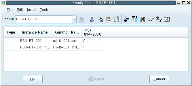

This screenshot shows the family table after saving to workspace, erasing from session, and the reopening. Note that 814-265C has been (silently) changed to '*'.
family table corrupted

Update: I have discovered the issue is not actually limited to the component doing the replacing being an assembly. It actually happens when the component doing the replacing is not the same type as the component being replaced. ie prt or asm.
If the component being replaced is a prt then replacing components that are asm get changed to '*'. If the component being replaced is an asm then replacing components that are prt get changed to '*'.
