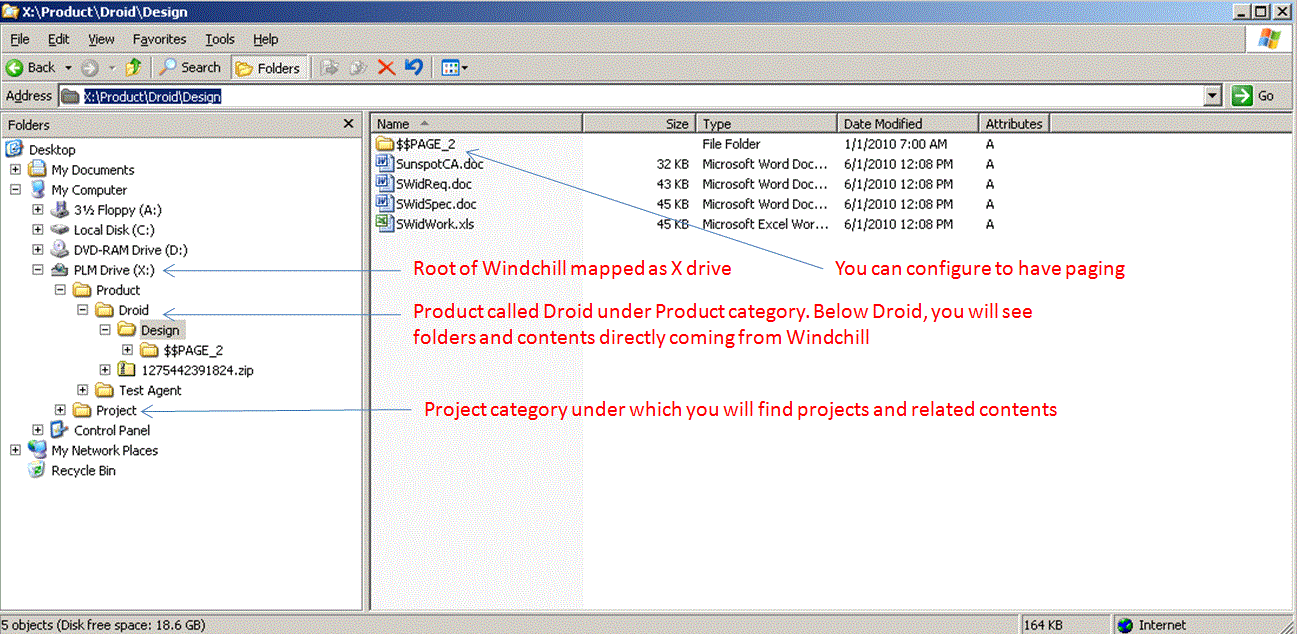

We provide a solution that allows you to map windchill to network drive
using one service account and mapped drive can be shared among users using
various mechanisms without them having to directly interface with Windchill.
*You probably need to confirm with PTC to see if multiple users accessing
content residing in Windchill using a single service account is allowed as
per their license policy.*
There are several use case for this solution. The solution can be easily
used with integration projects such as integrating Windchill with share
point and other content management systems.
Here is the screenshot of the solution
[image: Naja Drive.gif]

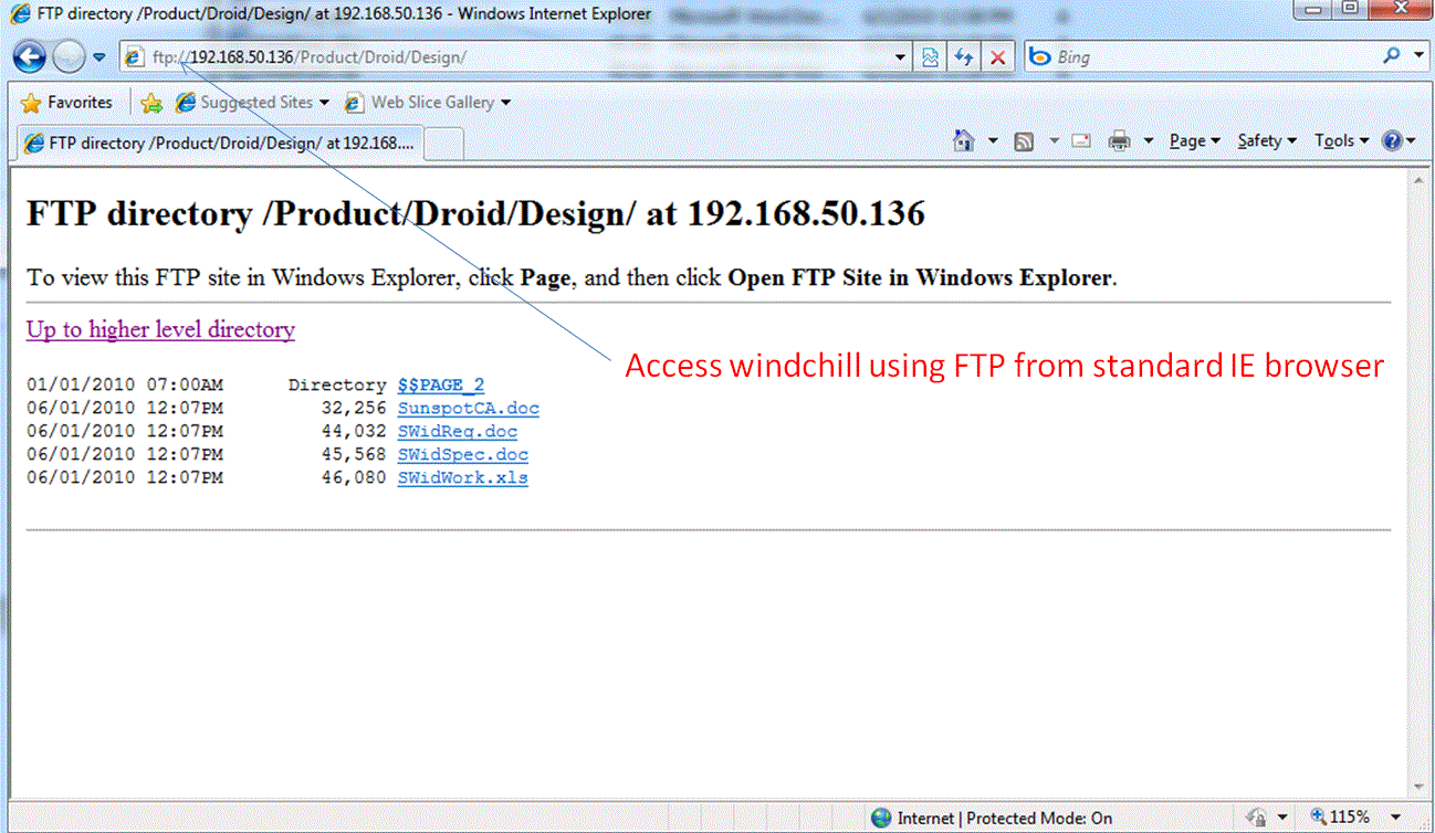

You will be also use the solution to give users access to windchill using
FTP capability built in within IE browser. I have attached the screenshot of
the solution.
[image: Naja FTP Drive.gif]
