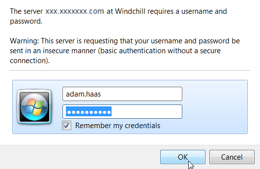

Our Windchill server address is http://xxx.xxxxxxx.com (no https) so each time we start Creo, we get the following message and have to click OK to continue. This isn't the end of the world but if possible, I would really like to eliminate the need to click OK.
I've tried changing IE settings, added our server as a "trusted site", etc but no luck. Does anyone know how to fix it?
Best answer by ChrisSpartz
IE is displaying the warning because the connection to the Windchill server isn't using https. If you configure the Windchill server to use https, that will get rid of the warning.

Chris,
That would be nice but I don't see that happening anytime soon. I was hoping there was a security setting that would override it.
