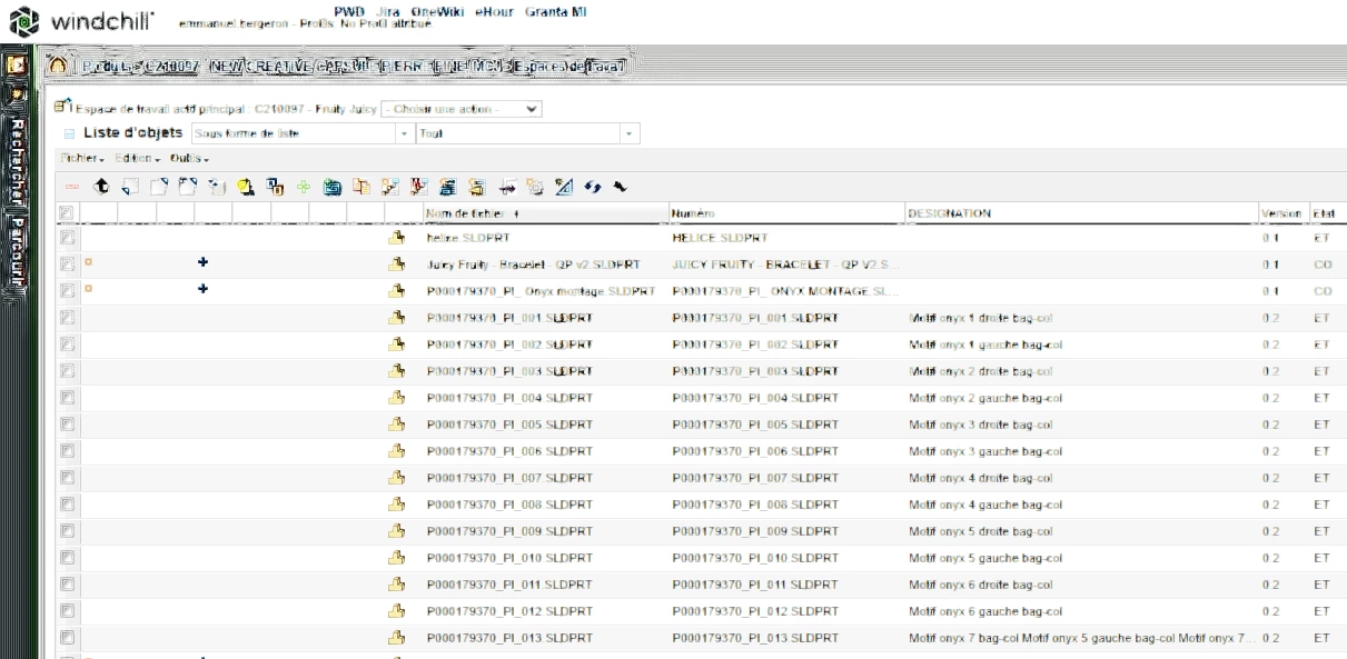

WGM diplaying with bad quality
I am using Windchill PDMLink Release 12.0 and Datecode with CPS 12.0.0.2
In remote works windchill is diplaying with bad quality I haven't this issue when i am working on site i am using zscaler

We've been using the "Change High DPI settings" option for a while but the failure mechanism in our case wasn't blurry window but a segmented screen (like a picture-in-picture kind of thing). The DPI settings change worked great on both the Workgroup Manager and Creo.

If possible could you please give us screenshot of display. Some time
if its a scaling issue you can refer Windows article  https://support.microsoft.com/en-us/topic/windows-scaling-issues-for-high-dpi-devices-508483cd-7c59-0d08-12b0-960b99aa347d#:~:text=Select%20Display%20%3E%20Change%20the%20size,high%20DPI%20settings%20check%20box.

i added pictures

https://community.ptc.com/t5/3D-Part-Assembly-Design/Windows-Display-Zoom-and-odd-Workspace-behavior/m-p/925798
I noted this behavior a few weeks ago. Let me know if this is what you are seeing.

yes it is a similar case but normally the user had setted 100%
i will verify
this issue is secluded and mabe driver or windows issue i am agree with you.
I use every day two monitor and  i don't have any problems with 100% scale

We've had several users with similar display issues. This article has helped: https://www.ptc.com/en/support/article/CS265134?source=search
Up till recently, the first solution (Add the config option high_dpi_enabled no) has worked
Just recently, I've had a couple of cases where the second solution was needed. (Maybe related to our recent Creo upgrade).
